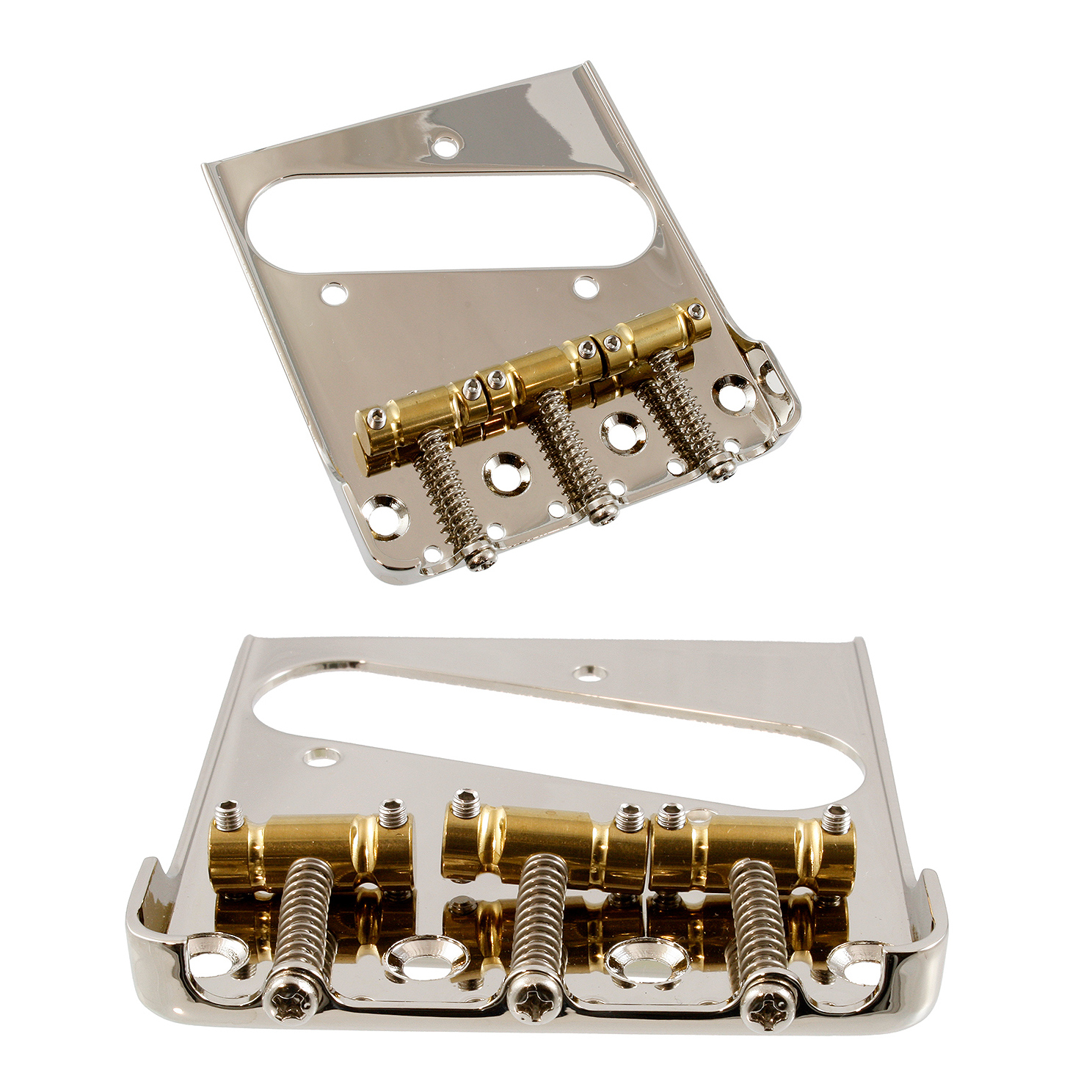

Also, get one of the cut-down bridges that allow the strings lower access for the Bigsby.

Only B5, I know the differences.  Not the least of which is the larger shaft on the hold down bar on the "licensed" models.  The original has a smaller shaft, which in turn... allows a smaller roller, which in turn, allows strings passing under the roller to be a little higher.  As for the bridge, I got one, a Fender with the brass "intonated" saddles, and got the skills to pay the bills to do a creditable job of notching it.  I can always add it later I guess
That you can. It's an easy thing to add later on. I must say, I do like the feel of a Bigsby. My very first guitar was a Tele (copy) with a Bigsby (probably a copy, too) on it. It was a lot of fun.
