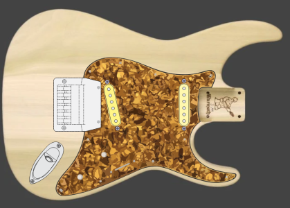

Yes, and I reverse-slanted it to give the higher strings a touch more volume and fatness.

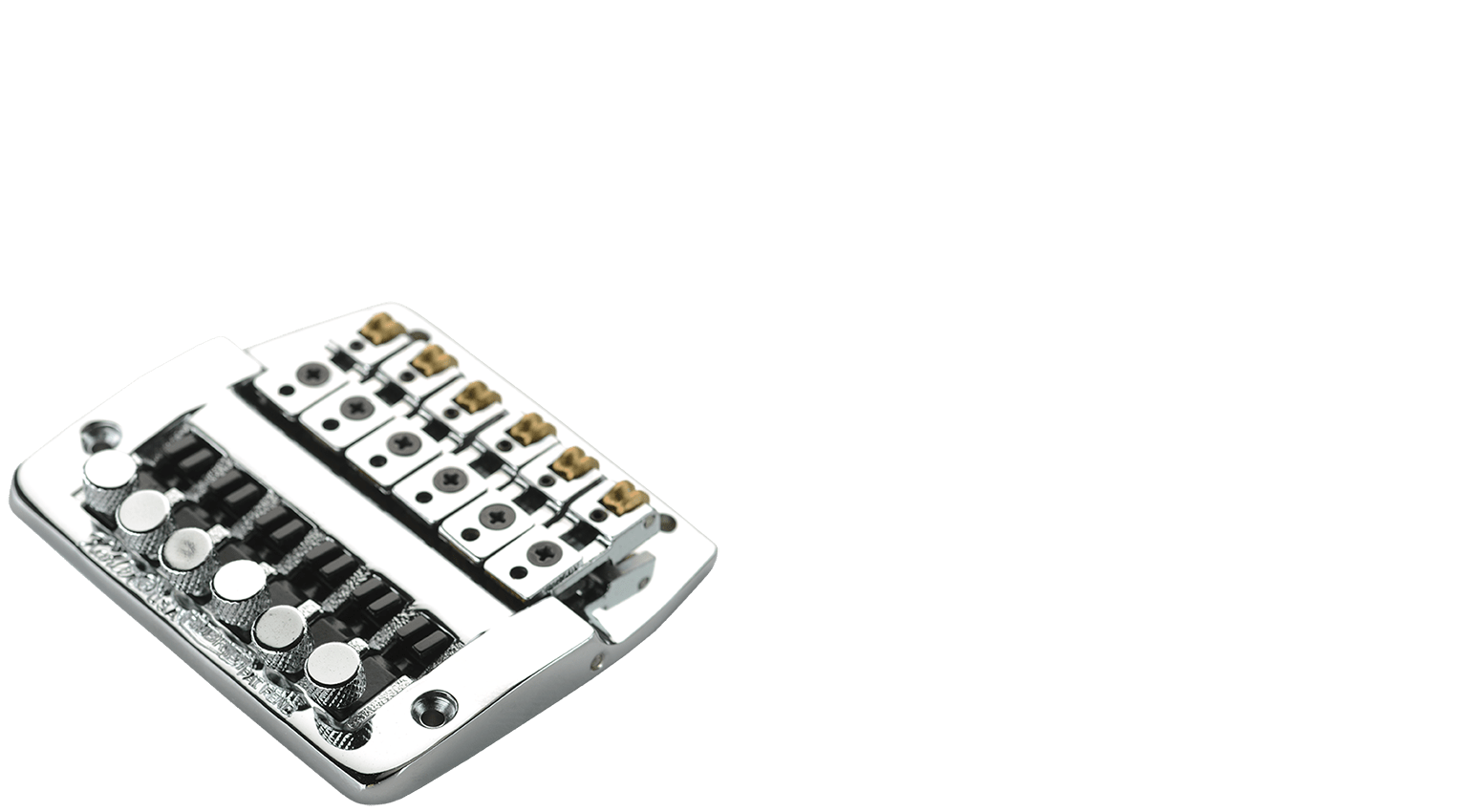

It's going to be running a couple of Kinman's "P90-in-a-strat-package' variants...

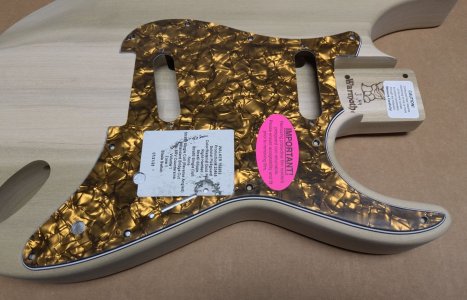

Still, will have to TRIM about 5mm out of the pickguard to fit the bridge in...
But that still leaves a couple mm of pickguard behind the pickup! :-)
Should look something like this:

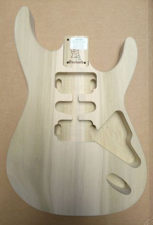

Anyway, body, pickguard, and a set of 'contoured heel' screws will be on the way soon. Then I will find out how close my guesses really are! Will this be the canary neck vehicle of my dreams???

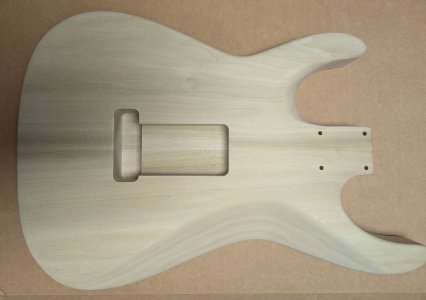

I assume you are not intending to use the poplar body shown, as the Schaller mounting screws would not have very far to go before screwing into a trem cavity.
I totally love the empty trem cavity ( weight reduction!). A little hardwood block glued inside can secure protruding bridge mounting screws.
As much as i like a rear-cavity 'no pickguard' for fancy wood tops, my lazy side really enjoys slapping pickups into a pickguard, no fussing with direct mounting to the body...
