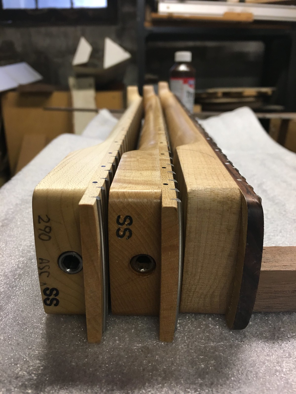

The profile is based off some mighty mite necks that I have. It's a simple C shape with no shoulder. I modified it to be thicker as you go up the neck, and verified that profile by laminating one of my standard thin necks with veneer (page 1 of this thread). The standard thin profile has some shoulder, then goes really flat, more like a D shape. I took comparison pics, but it's hard to see any differences...

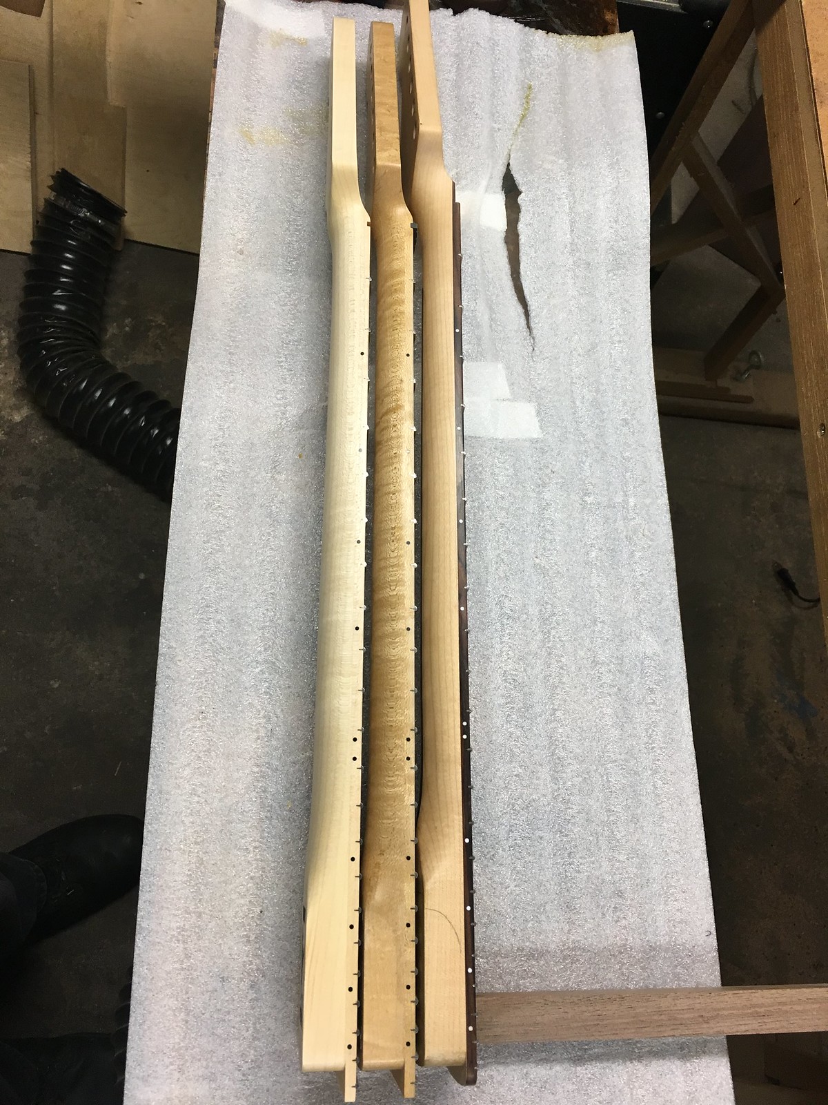

Now this is interesting. The new neck on the left was a happy, fast growing maple. Look at the growth ring spacing.

While I'm sitting here profiling necks, I decided to look at the standard thin. While it looks like the Warmoth example at the 1st fret, look how it flattens out as you go up the neck, and starts to get a "shoulder"...
The Mighty Mite neck is more of the typical strat profile, the C shape...
...and the neck I just did.

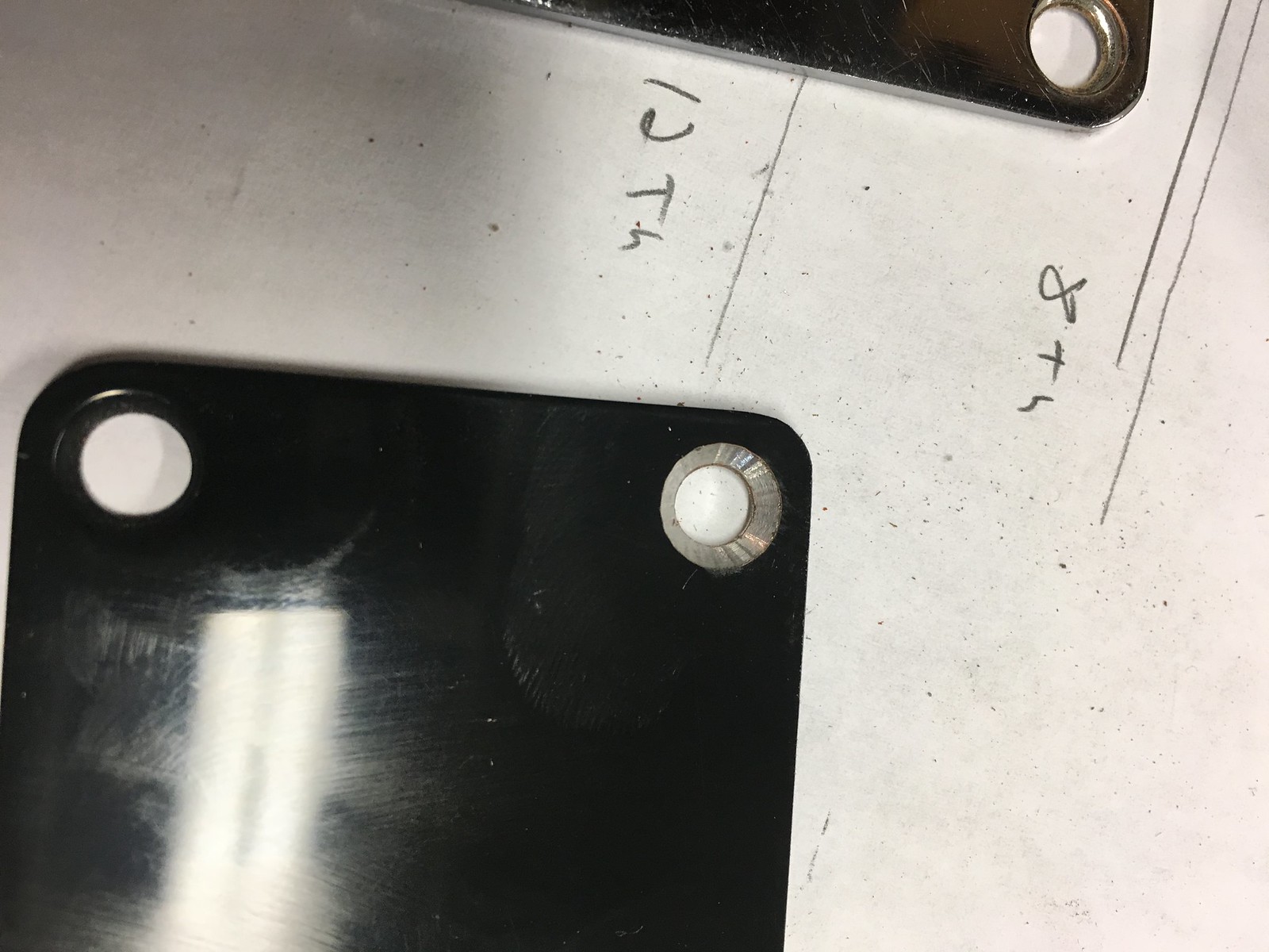

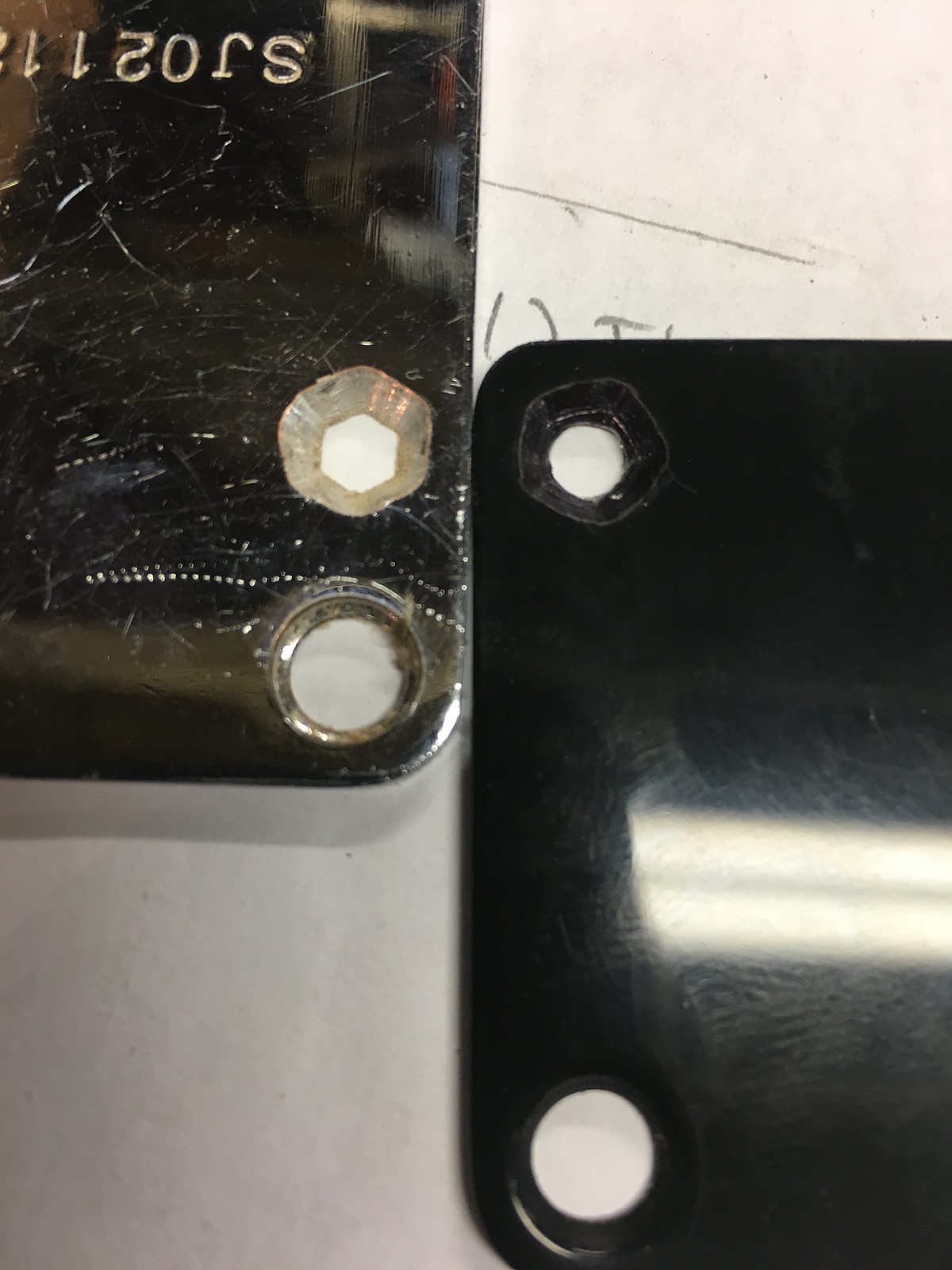

WHY CAN'T I MAKE NICE COUNTERSINKS!!!  :sad1:
The chrome one I used a 5 cutter countersink, what do I get? A hexagon!!!  :sad:
Then I used a 2 cutter countersink on the black one. The results? A Pentagon!!  :tard:
Or maybe... it's a pentaGRAM! Oh noooo, my guitar is going to be EVIL!!  :evil4:
I'm hoping Doug chimes in here, but I've always found that the secret to countersinking is centering and securing. Center the bit in the hole first, secure the work so it won't move, then slowly feed the bit into the work, hopefully on a drill press. The malformations you're seeing are probably caused by the bit grabbing the work and moving it as it cuts.

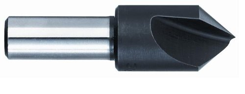

Get the single flute counter sinks that have only one cutting edge. I've used them for years and they work without chattering and giving you those pentagons and such.

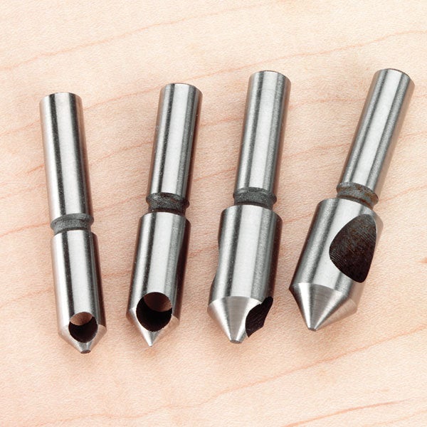

I used to have that problem, then one of my brothers gave me this weird-looking countersink bit that works like a charm. They look like this...
They call them "single end" countersinks, but I've seen regular countersinks called that, too, so be sure to look for the ones with what looks like an angled hole drilled through. To look at them, you wouldn't think they'd work at all. But, they produce incredibly smooth, round results. I think it's because they come to a conical point so it centers well, then the vast majority of the contact surface is actually smooth instead of air or a cutting edge. So, it stays centered as it cuts, instead of being pushed from side to side by the resistance of the workpiece. Highly recommended.
Ooohh, read up on the zero flute ones, you can easily resharpen them too! I'll have to get some!  :icon_smile:
I put the plate in a cross-slide vise, now my guitar is no longer evil. I will be able to play major chords  :laughing3:

I should mention my brother is a commercial glazier and uses those zero flute countersinks almost exclusively on aluminum and steel, so you know they're gonna last forever on wood and plastic. Plus, in looking around I notice they're available in cobalt as well. For guitar work, one or two made out of that would probably become heirlooms.
