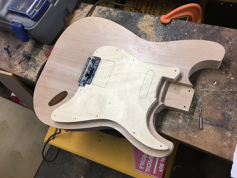

Figured I'd save some drum sanding time after bandsawing by using a 2" straight bit with bearing on the router table for the sides. Hahahahahaha, I knew it would happen. 3/4" of the upper horn, gone. :sad: Don't go to work all day, come home tired, and work on stuff that requires your utmost attention.  :dontknow:
So the body is less horny.  :laughing3: I reshaped it a bit so it looks intentional  :laughing11:
Doesn't hurt it a bit. Looks good.
That wasn't a mistake at all. You designed it that way.

Boring stuff today. Made a pickguard template. I didn't do the neck area because I will be cutting that manually around the neck instead of it being under it. I hate having to remove the neck every time I need to remove the pickguard. Also, the pointy part will need to be reshaped to match my "custom" horn shape.  :laughing3:
Nice template. I also don't like removing the neck to take the PG off. Won't you be able to see under the extension by cutting around it? I have considered cutting the extension off to remove the extra fret but then I wouldn't have the extra fret.
Yet another reason to install threaded inserts in the neck heel. Not only makes removal/installation easier, it doesn't wear out the holes in the heel like wood screws will.

I know you're right. One of these days I need to do both my Warmoth necks. Maybe I'll just wait until I have a few more so I can do a handful at once.  :icon_biggrin:
Yeah, once you're set up, you can sorta "batch process" them. Drill all the 1/4" holes, then all the 3/8" reliefs, then do all the tapping, then thread all the inserts in. Wear your wrist out, and have to change beer holder hands.
I don't have a gap in the "prototype", but that's because I routed the neck pocket deeper than normal. Looking at my regular strats, yeah there would be a void there. Maybe paint that area black so it's less noticable  :icon_tongue:
I put inserts (steel, not brass) in my first Warmoth neck, because I had to remove the pickguard occasionally to replace the battery for the active pickups. Now I figure, if I ever strip out a neck hole (and I haven't so far), that would be a good time to install inserts  :icon_biggrin:
