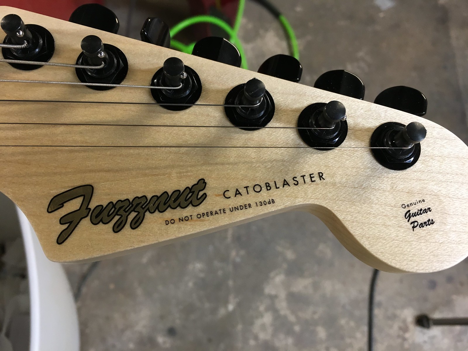

Here's the tongue-in-cheek headstock decal  :laughing7:
Nice decals. I think I might adopt the "Genuine Guitar Parts" annotation  :laughing7:

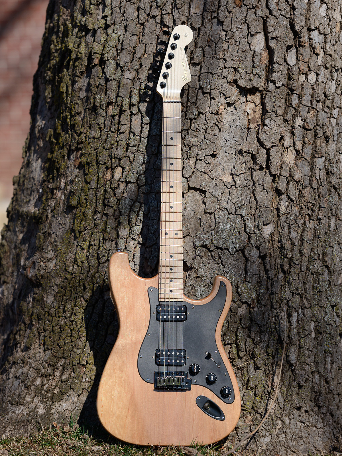

Here it is, the totally original "guitar up against a tree" photo.  :laughing3: The more I look at this, the more I think, "I can't wait to spray tinted lacquer"  :toothy10: :laughing7: :help:
That's a genuine American Beauty! Now, if you wanna truly amaze your friends even more,  then before you tint the lacquer pull the tuners and mask the headstock so only the face is showing, and bury those decals in clear. You need about 3 - 4 coats before you start sanding, then sand w/ 320, shoot a coat, sand w/ 320, shoot a coat about 6 or 7 times. When you can't see the edges of the decals any more, sand w/ 600/800/1200. Then buff it out w/ compound, then polish.

Here it is, the totally original "guitar up against a tree" photo...
Turned out beautifully!
Thanks for this, the tinted lacquer was in reference to the next build, the limba hardtail. But definitely lacquer everything, the neck should be clear since roasted maple has a nice dark look to begin with. What about before applying the decal? What is your suggestion for the perfect base prep to apply the decal?

Thanks, I was worried that the the "design liberties" would unbalance the guitar, but even with those heavy tuners it still feels balanced. No SG neck dive  :icon_tongue:
As suspected, the humbucker 2 and 4 positions, while interesting sounding, are pretty unusable as they are half the volume of 1-3-5. I can't believe how stratty-sounding the thing is with humbuckers, I think it's begging me to put a single coil in the neck position  :laughing11: The neck is very resonant for a modern construction neck, and lighter in weight, maybe I can specify fast-growth maple for my next neck?  :icon_biggrin: Overall I'm happier than a pig in processed food  :toothy12: :toothy12:
