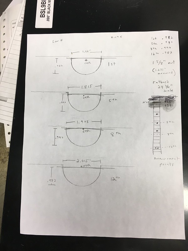

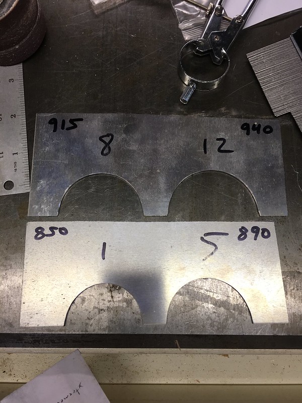

Today I get to void the warranty on the neck  :redflag: I got a fatback solely to reprofile it to my liking. Here are the profile templates:
I did record the fatback profile for posterity  :icon_smile:
I'll be interested to see how your re-profile goes. I put a Clapton Soft-Vee on my Jazzmaster and I'm still not sure about keeping it that way. It's been a little painful on my thumb playing barred chords.
I was thinking of either taking off some of the peak, or just getting a new Standard Thin profile. Taking the Vee down would certainly be less expensive, and since it's finished in satin lacquer, it wouldn't be all that hard to refinish.
