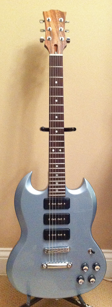

I turned 30 back in May and to commemorate the occasion, me and a buddy put together an order from Warmoth.  Everything finally arrived last week and I got her all assembled this weekend.  Feast yer eyes on my sweet rocking beast!
Body:
1 3/4" mahogany
Blue Ice metallic paint job (as close as I could get to Gibson Pelham Blue)
Standard SG control routing
Gotoh tune-o-matic bridge and tailpiece
7/8" jack hole on the side with an electrosocket jack (the jack on the front of my Gibson is super annoying)
No pickguard yet, but I've got a black one and I'm trying to decide if I should install it or just leave it clean
Neck:
24.75" conversion neck
Mahogany with rosewood fretboard, clear gloss finish on back and headstock
6150 fretwire
Pearloid dot inlays
Graphtech nut precut and installed
Schaller mini locking tuners
No truss rod cover yet, the Warmoth one is pretty crappy so I'm looking into getting a custom job
Chrome neck plate with black pad
Electronics:
3 custom-wound P90 pickups from Jon Moore (www.tonefordays.com)
Bridge pickup is 10k and then the middle and neck are wound progressively weaker
3-way toggle switch wired normally to the bridge and neck pickups
Middle pickup wired to be always on, but can be turned off with its own volume control
Master tone control with 0.022 uf capacitor
With this setup I can get any pickup in combination or alone
Overall I'm very pleased so far.  The wiring was definitely the hardest part of the assembly, except maybe for figuring out where to put the strap button on the neck side.  In the end I decided to thread one of the neck bolts through it, but I'm not sure this is a viable long-term solution.  Any of you out there who have put together a Warmoth SG are welcome to chime in with your strap button placement advice.  The weight is pretty amazing, my Gibson SG weighs in at around 6.7 lbs, and this lovely beast is over 9 lbs!
The pickups are fantastic.  I went with unoriented Alnico V magnets, which are higher output than Alnico II's, but a bit warmer than normal Alnico V's.  With the middle pickup turned all the way down, I can get all the classic P90 SG sounds I was looking for, albeit a bit thicker due to the hefty body.  With the middle pickup dialed in, I can get some great quacky tones (think the 2 and 4 positions on a strat, but with more balls).
At this point I just need a truss rod cover and maybe a pickguard, and the frets could use a little dressing down.  They play great, but are just a tad tall for me.  Also, I need a picture photo of the final product!

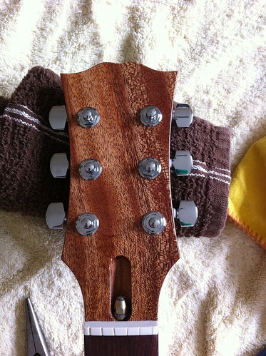

Close-up on the headstock, the gloss really makes the wood grain pop...

I also need to get a better photo, because those in my original posting just don't do it justice
