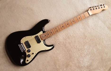

I just got my roasted maple/roasted maple neck and am now trying it out. The tone improved dramatically over the standard maple/rosewood neck that came off, but I expected that anyway because of the tonal qualities of the rosewood. How much different it is to a standard maple neck I can't say. My other guitar has a varnished maple neck on it and I may change that and have a good comparison.
Surf n Music mentions burnishing his. What would be a good tool for that? I have an old steel tool burnisher and I also have a piece of cotton fire hose. Any suggestions? I know that over time it will get burnished just from use but I'm open to new ideas.

It's not a tool, per se. It's a series of abrasives that go beyond what you'd normally use on wood. Warmoth's parts are normally sanded to 220 grit, which is fine as far as it goes. But, if you want the ultimate finish, you move from 320 to 2000 grit in stages on a raw wood neck. The farther along you go into the higher grits, the longer it takes to make a difference, but it's well worth it. Figure on spending an hour or better doing it. Once you're done, it's a satin finish like you've never felt, and it stays that way, unlike an artificial satin finish. There's a thread on it here if you're interested.
Be aware that you can't do it with any wood - regular Maple, Mahogany, Koa and probably one or two others I can't remember won't tolerate being naked. They'll twist up on you and make you so angry you could pinch them. But, many of the exotics and the roasted Maple are happy to frolic unencumbered by any sort of artificial finish.
Thanks for the information, Cagey. I'll check the link you provided. I've polished aircraft windshields and still have the stuff to do it. I can go up to 12,000 grit if need be. On that stuff, the back is rougher than the grit side. It sounds much like what I've done with lexan but I can stop sooner.
If you have stuff like that lying around, it works wonders on frets. Particularly stainless. Take 'em to a mirror finish and you won't be sorry. Best neck you'll ever play.
