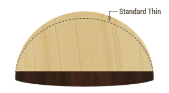

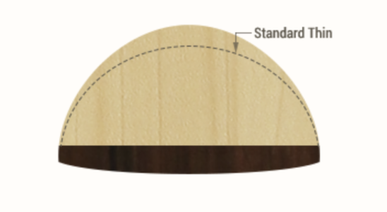

Here is a Warmoth's comparison between the two profiles. If the truss rod is sits at the same distance from the fretboard, then it shouldn't be a problem to reshape the neck a little bit.
Boatneck
- Similar to: Vintage Tele® (52 Reissue)
- Thickness at 1st Fret: 1.00"
- Thickness at 12th Fret: 1.00"
The Boatneck is the same thickness as the Fatback, with smaller shoulders. This results in the same fat feel in the palm, but easier access for the fingers and thumb.
59 Roundback
- Similar to: 1959 Gibson® Les Paul®
- Thickness at 1st Fret: .860"
- Thickness at 12th Fret: .960"
The 59 Roundback is based on early Les Paul® neck dimensions. It is also our neck profile most similar to the PRS® neck shape.
