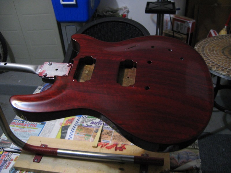

Just a follow-up... I decided to spring for a good brush and give that a shot. I have mixed feelings about how it turned out.
I'm glad I didn't try to shoot it. This is some saggy, droopy shit. It's like painting with thin maple syrup. It definitely flows out, so on the flat surfaces it's great. It's nice and glossy and level, as if you'd already paid a lot of attention to it with a buffer. No brush stroke artifacts, no tears, none of that nasty stuff.
But, it doesn't know when to quit. It's like it never gets a grip. It doesn't congeal at all for an absurdly long time. So, the vertical surfaces want to sag like... something really saggy. I was able to mitigate a great deal of that by picking it up with the brush, but eventually you run out of time with that trick because it starts to "skin", and you can't touch it any more. So, I'll have some sanding to do.
But, I expected to have to sand back anyway, so that's not the end of the world. What's disturbing about it is the body style. It's a VIP body, which has all sorts of curves and sharp edges. Sanding on that terrain is just begging to break through to the wood. I know because I've done it several times already. Thank the FSM I had the forethought to keep a jar of the stain mix I used to color the thing, as it's highly unlikely I'd be able to reproduce it exactly. There's a lesson in there, if you're paying attention...
On the plus side, while I have no way of measuring, I think the coating on there is about 3 times what you'd get spraying it, and there was no mess or heavy concentrations of airborne toxins. Lot to be said for that. So, I'll knock this back tomorrow to level out the sags, put another coat on it, then depending on how that works out, maybe even spray a final in the late afternoon. Hang it for a couple weeks, and see where we are.
Not the best picture since it's in unnatural garage-level light, but the flash shots were ultra-nasty. Any way, you can get an idea of where it's going.
Incidentally, that was shot probably 40 minutes after it was painted and it was still tacky enough to take permanent fingerprints.

The spots I had to repair had bare wood showing, which was almost totally unexpected. But, I stained it before sealing it - that is, I used a clear sealer/filler/clear coat. It's the wood that's stained; none of the coverings are tinted. So, just a dab of the original stain on a piece of towel, rub the bare spot, and it's more or less gone. It's a thin spot now, finish-wise, but you can't tell by appearance that I did anything.
