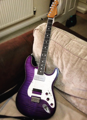

Took me a little while to build but my guitar is finally finished  :headbang:
I think installing guitar electronics has given me crippling depression and the soldering iron has given my finger calluses 3rd degree burns.
But finally after a lot of screw ups it's finally done  :hello2:

That's a fine-looking Strat you've put together there, Mr. VQ. If it sounds as good as it looks, you must be very pleased.

Very nice looking.
Specific details about the parts would be nice to hear.
Oh yes my apologies.
Chambered Strat with a 25.5 scale length
Purple dyed flame maple top on Roasted Swamp Ash w/ pearloid binding and a black back
Universal routed and with a 2TEK bridge
Hot P90 neck pickup and an MJ-made JB Trembucker for the bridge connected to 1 meg tone and volume pots
Q-parts purple crystal dome knobs
Pearloid pickguard with the delonge volume position
standard thin Warhead neck
Roasted Maple with Ebony fretboard & pearloid diamond inlays (w/ first fret omitted)
Earvana Graphtech TUSQ XL nut
10-16 compound radius with SS6105 stainless frets
Schaller locking tuners
Abalone side dots (to blend in with the pearloid binding to train me not to look down when playing on stage)

So, how do you like that 2Tek bridge? Would you use another one?
Oh yes definitely. Since I've only used a tuneomatic really in the past it's taking me a little while to get comfortable with when it comes to palm muting though but yeah, it's awesome. Any order from Warmoth will include a 2Tek if possible :D

I guess I'll never TRULY be able to hand on heart tell you that it's 100% worth it because I don't have another guitar that's the exact same but with a different bridge to compare.
When it comes to value for money, I guess I'd say it's not that great, let's be real. The only other experience I have with bridges is really a tuneomatic, never played a bridge that comes down this so it's kinda new to me altogether if I'm honest.
But I likey ^_^
