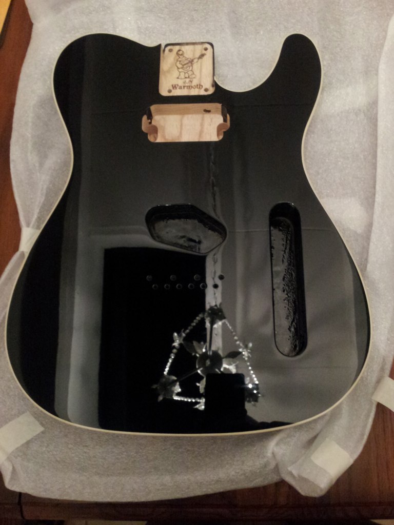

The routing Warmoth does after a body is finished is clean.  They maintain their tooling very well, yielding such results as this:
Like line6man, I recommend you color the cavity if it's a rear-rout guitar and you don't want the innards to show.  Leather dye works well, as does india ink.

Also, it's not that tough to do a good job - all you gotta do is throw money at it. Buy the best tools and use them properly, and you're there. Best shot I've got is of some control holes I drilled a few years ago during a build for a member here...
That's a high-gloss poly finish from Warmoth. I used a Forstner bit to drill those holes, and as you can see, there are no chips or other anomalies marring the surface. You get similar results if you need to do any routing if you buy into carbide bits. They're sharp, and they stay that way.
