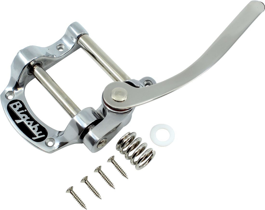

I wanted to make a velocity with a bigbsy, and am really unsure about it. I want a Bigsby because it's the trem I like the feeling and look of most (have FR, Bigsby and Strat)

I DO NOT think this is a stupid idea.  I think this is great.  I'm a fan of the bigsby and I really like mine on one of my W-teles.
I think that if a TOM fits, then a bigsby will as well, especially if you use one of these:
with one of these:
EIDaa2ViMiKE2QDI6EayrOYGX7AcrTMbjjC9jjIYaBw6OGx6hpLGf9cDzjBu2KA5tFAUn8-Em9tpqwBADUp2jeQqj8dyGeMz7pwZbZgW-jL3-QgSXi4
If you do that, then you don't have to worry about the carve of the top or anything.  Just bolt it to the existing TOM stop-tailpiece studs and have at it.  Should work great.
