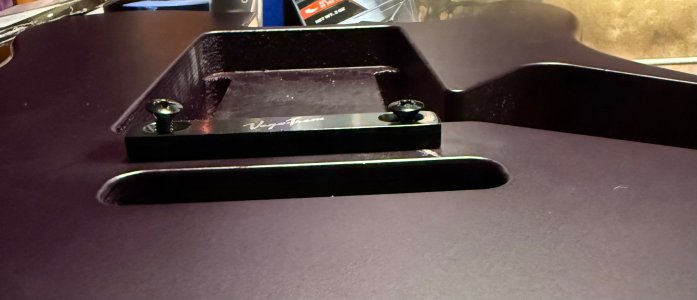

So I had bought a vegatrem to install on a tele/strat hybrid body. I had it routed for an American strat bridge. However, when I went to install the bridge plate, the screws would not go straight in no matter what. It’s like the spacing on the bridge plate is too narrow, even though it’s supposed to fit an American Strat route. What can I do, if anything?IMG_4170.jpeg

Left screw does not appear to be drilled perpendicular. With the screw backed out, is the hole in the wood centered in the hole in the bridge??
It is drilled perpendicular. That’s the bridge plate pulling it that way because the hole in the plate does not quite make it to the center of the hole in the body.
What studs did you use?
And I would also ask Vega-Trem for support in your case, since Warmoths routing is only designed to fit the American Standard Fender® Tremolo, while the Vega-Trem is designed to retrofit different 2-point style trems.
I did reach out a few days ago but I haven’t heard anything back yet. The studs are standard fender American, which the vegatrem is supposed to fit.
