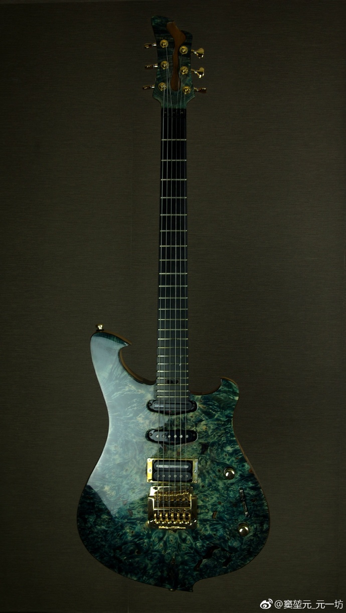

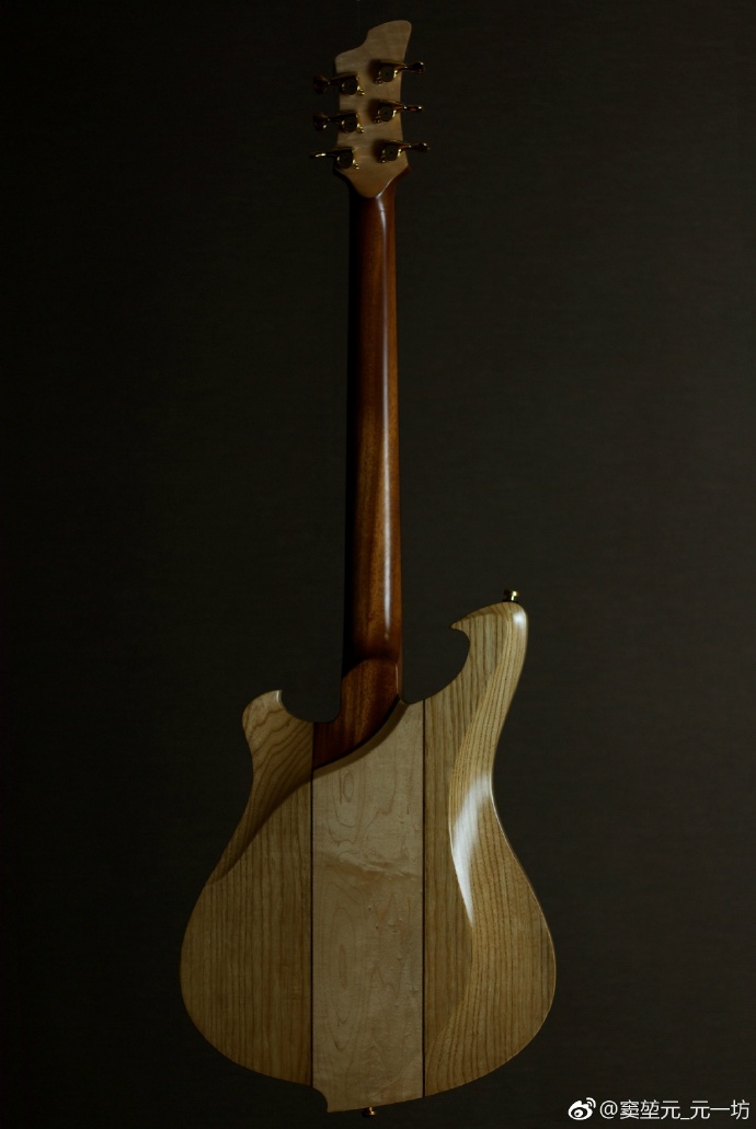

Like a builder on our local Forums, this was what he  build earlier, 6 years ago, an ordinary tale
Lately, I see him making frets like this;
And this is what he built recently.
What I try to say is, he is an example of, someone willing to overcome a lot of obstacles to make something the way he believes, can make a lot of progress.

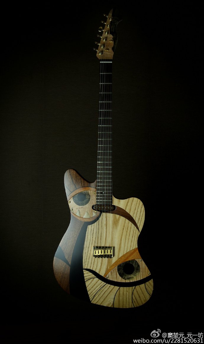

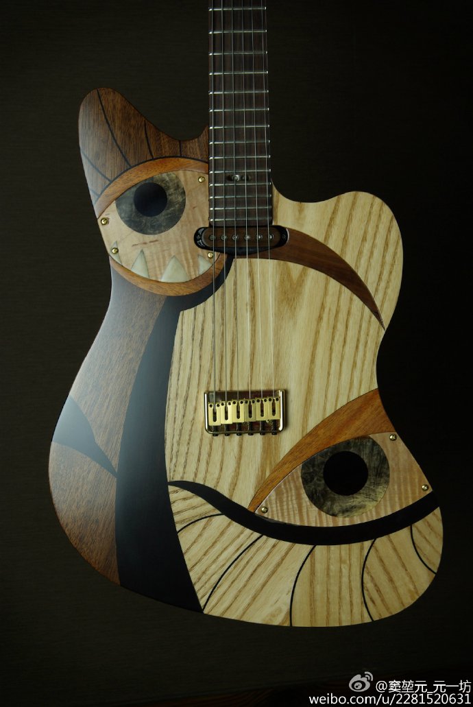

Here is another guitar builder on our local Forums, same, aesthetically like or not, I like to learn from him “how “ about the building process.
I like your interest from a design and craftsmanship standpoint and I find the use of a top wood as a pickguard very interesting. I'm inspired to research photos of this. My own position is that I will use a pickuguard on a front routed strat body but I don't like pickguards at all on teles. But your examples from a design perspective are really good.
