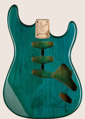

Satin transparent turquoise
Thanks! I'm wanting to build one with this color, but the Warmoth sample for that color looks a lot more green than blue to me.
