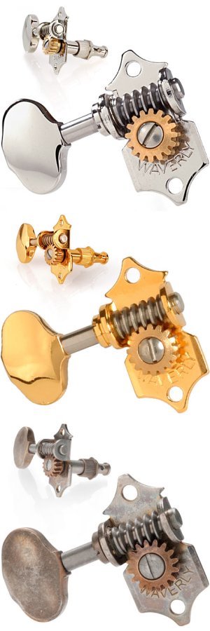

Steve_Karl said:
Are the tuners on the problem guitar able to be tightened with a screw in the middle of the knob?
If so make sure they're not too loose.
I bought a set Schaller mini locking for my last build and one of the tuners was loose and causing problems for the tuning of that one string.
It didn't feel loose, when turning the knob, it felt exactly the same as all the others, but it was loose inside, and enough to cause problems.
My tuners are waverly open tuners, often used on acoustic guitars, those one:
