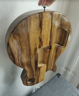

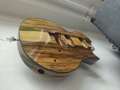

Here are some pictures. I really love the combination of Regal body, Black Korina and Tru Oil.
Next Steps: BC Sheen & Conditioner, 1 month drying, fine sanding (2500 grit to get the oil swirls out), assembly.

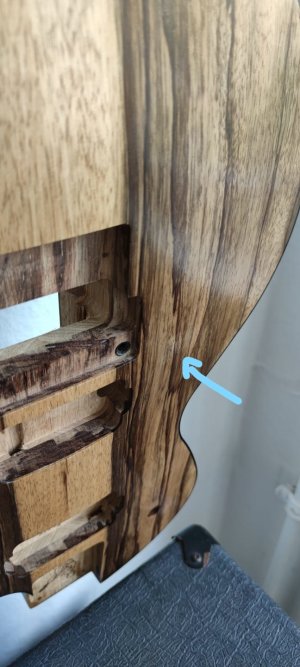

OK, new milestone, new "problem" (albeit, a very small problem): I applied BC Sheen and Conditioner - that stuff is crazy nice. Before I sanded down to 2500 and noticed that the gloss was harder to get out on some spots. So I applied Sheen and Conditioner and then sanded down to 3000 again (which had a great effect btw!) before applying a last round of BC Sheen and Conditioner. I finally buffed the guitar.
However, for some reason, one spot on the front of the guitar somehow "whitened" in the process. You can only see it if you really want to see it but, well... you can (see attached photo). Any idea how this happened and can I "fix" it? I find it unlikely that I sanded through with 2500/3000 so I'm a bit surprised.

yes, if the area is sand thru, wipe the area with naptha.  Let dry.  Then rub in six coats of tru-oil thinned 50% with naptha.  You'll just need the tiniest amount.  Rub in with you finger cleaned in naptha.  Let dry a day between touch ups.  That should fix it.  Let dry two weeks.  No more sand paper.  Only use a gentle rub with swirl remover.
Hmm... I'm inclined to try but I am a bit worried that this approach would make the area even more prominent - don't you see that as a risk?
Nope, I've done touch ups with tru-oil and they always work out fine.  The stuff melts into the previous layer and witness lines disappear.
