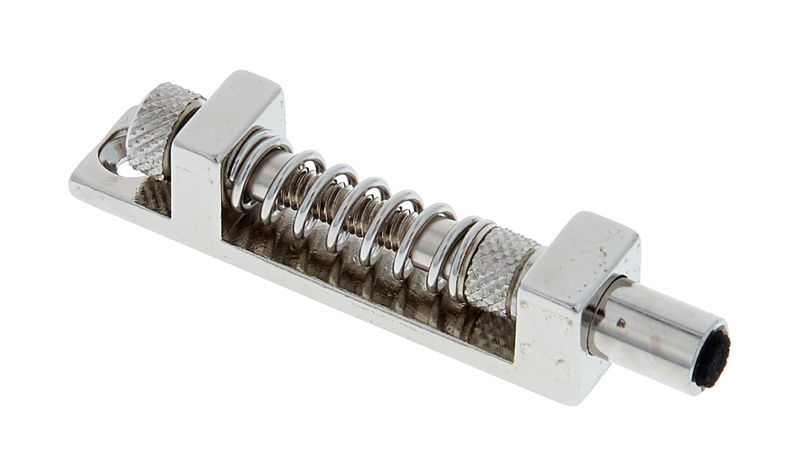

... but check out the Goldo Black Box. You’d have to order it from Thomman in Germany, but it’s only like 30 bucks.
I found it, but it took a while because it’s Back Box, not Black Box.
Here’s a link and an image
