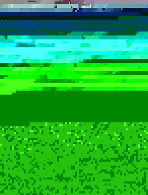

I am in the process of building my first strat and decided to go with tru oil for my finish.  Learned a lot!
1. Steel wool can be oily and leave behind tiny hairs of steel that would rust and ruin the finish.. I've been using a scour pad in between coats instead.
2. Most old t-shirts or lint free rags STILL have lint in them.  I finally switched to coffee filters.  Folded edges make for less streaks when applying.
3. Let the Tru-Oil dry completely before trying to scour or wetsand.  I've been using Boiled linseed oil to wetsand, wiping the excess off completely for a smooth surface before any more coats.
I've lost track of how many super thin coats I've applied.  Apparently, this causes more of the 3D or moving of the grain effect because every layer refracts the light uniquely due to the streaks that are left behind in each coat.  I don't know how to polish it so that it will have no streaks but I'm sure I'll read about a way in one of these forums.
Wow! That looks really nice! Don't often see Tru-oil over colors. Usually, people use it for natural finishes.
dude...did you hand apply that color?  Nice job.
