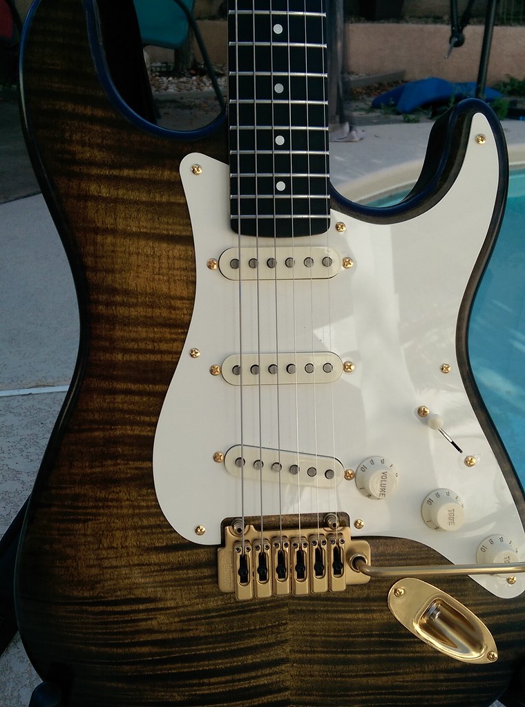

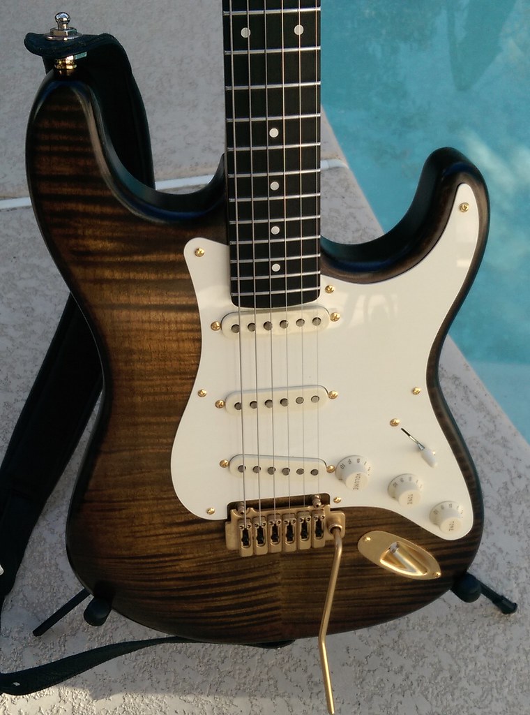

Here it is, boys and girls.

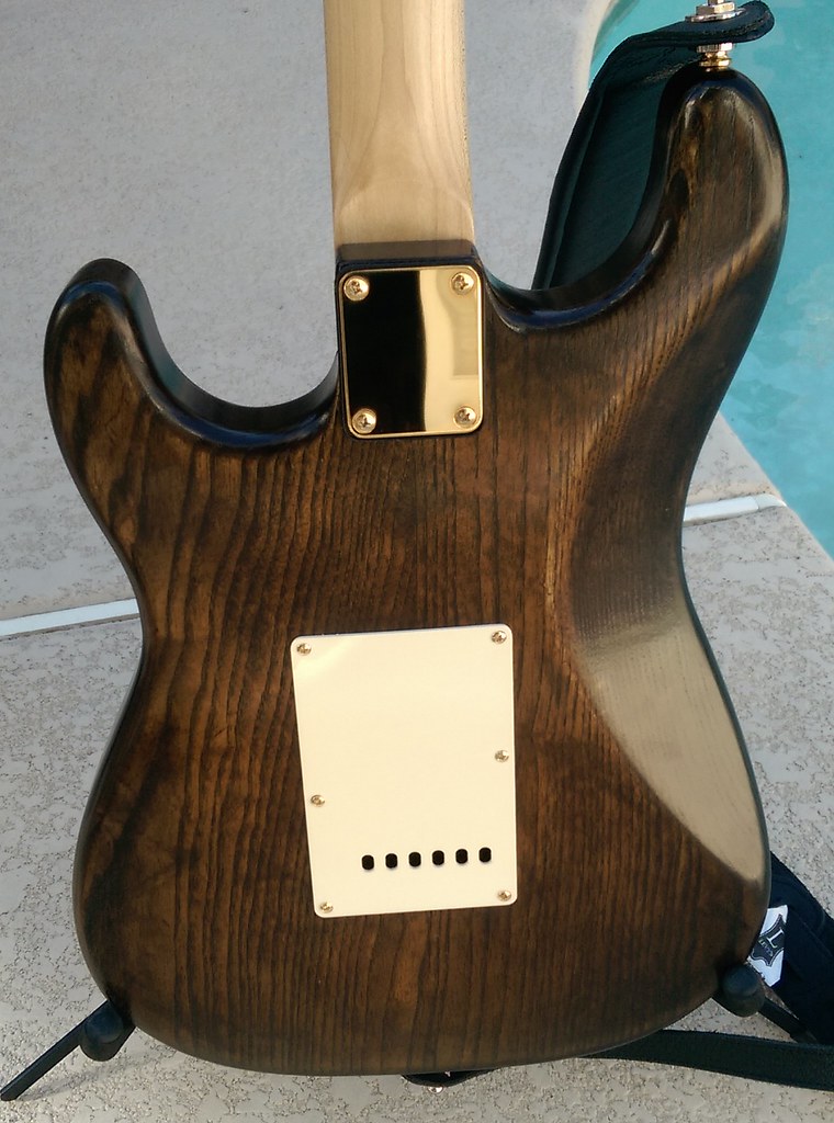

This is a flame-maple-on-ash chambered Strat body.  I dyed it with General Finishes water-borne dyes, first their ebony, sanded back and dyed amber, and bursted with walnut and ebony.  The clear coat is Tru-Oil.

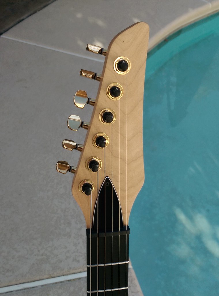

The neck is a Carvin unit, with what I think is a 14" radius, given that's the standard radius Carvin offers.
The bridge is a Wilkinson.  Tuners are Planet Waves self-trimming lockers.

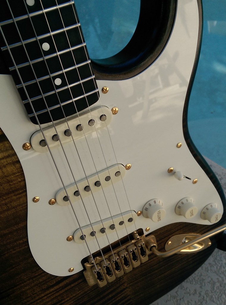

Pickups come in the form of a loaded pickguard cannibalized from an Eric Johnson model Strat.
Thanks, guys.
I took a page out of Cagey's playbook and mounted all five springs for the Wilky, and it really changes the feel when I bend the strings -- changes it for the better.  More closely approximates a fixed bridge, I think.  Gotta tell you, those EJ pups really sound nice.  Very "sproing-y" - that classic Strat sound in spades, albeit with the accompanying single-coil hum.  I've been playing it in a room where the lights are on a dimmer, and that sucker really spews the sixty-cycle noise.  So I turn off the main lighst to play.
Curiously, the middle position - territory I never found interesting before - really sings on this axe.  I still have some tweaking to do - a small twist of the truss rod to get just a tiny bit more relief, and a little adjustment to the saddles to get a little rounder radius at the bridge end - and then it will be truly dialed in.
Anyway - thanks for the kind words.  This one took forever (they usually do, for me) but has absolutely been worth the wait.
Bagman
