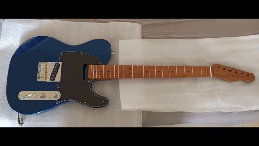

The Teilecaster

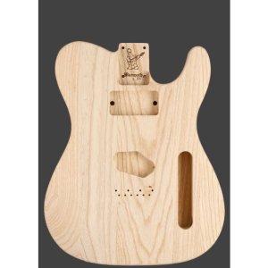

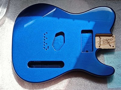

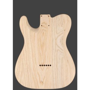

I thought a lot about the specs, missed some nice Telecaster bodys in the showcase, because I was thinking too long, but then, about 10 weeks ago, I saw them: Telecaster Replacement bodys, swamp ash, "Multi-Piece for Solid Colors", full contours, standard top rout (but with universal tele neck pickup), 155$ each!
I chose the lightest of the bunch and ordered it to be painted in spectra blue, 'cos I love metallics and I don't have a blue guitar yet.

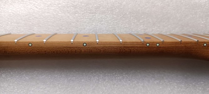

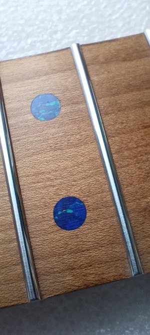

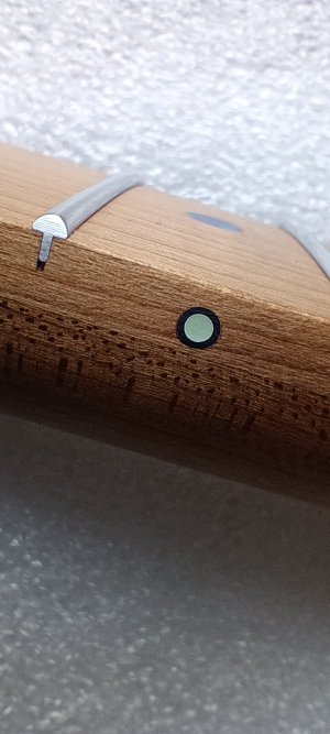

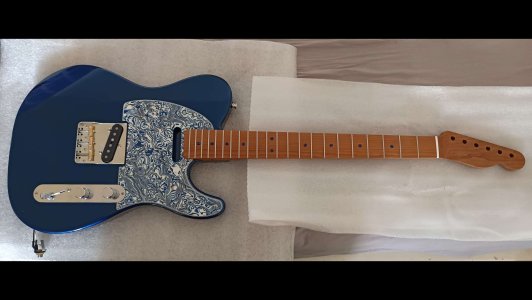

I also ordered a neck. I didn't think about neck dive when I ordered it, but for some reason I thought this guitar needs a really thick neck, so it'll have a fatback profile with 1.650" nut width. Premium Azurite Malachite dots to (hopefully) go with the paintjob.
Telecaster® Replacement Guitar Neck
Construction:
Modern
Shaft Wood: Roasted Maple
Fretboard Wood: Roasted Maple
Nut Width: 1.650" (42mm) - Vintage Medium
Right / Left Handed: Right-Handed
Neck Back Profile: Fatback
Fretboard Radius: 10" - 16" Compound
Number of Frets: 22
Binding: None
Fret Size & Material: SS6105 - Narrow & Tall (Stainless)
Tuner Hole Size: Vintage Style (11/32")
Inlay Shape: Premium Dots
Inlay Material: Azurite Malachite
Side Dots: Luminlay w/ Black
String Nut: Standard Nut - White Corian
Mounting Holes: Standard 4-Bolt
Neck Heel Shape: Tele® Shape
Finish: None

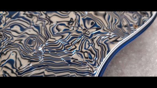

From Warmoth I also ordered a neckplate and pad, screws for contured heel, Gotoh vintage tuners and vintage "In-Tune" bridge, string ferrules, all in chrome/nickel, and a blue shell pickguard!

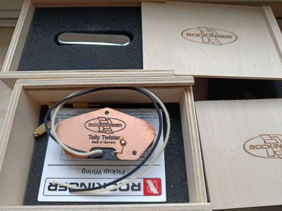

Rockinger is making really good sounding, inexpensive pickups. I went for the "Telly Rhythm" and the slightly hotter wound "Telly Twister Bridge", both classic Alnico 5 singlecoils. They come in those wooden boxes!

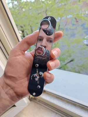

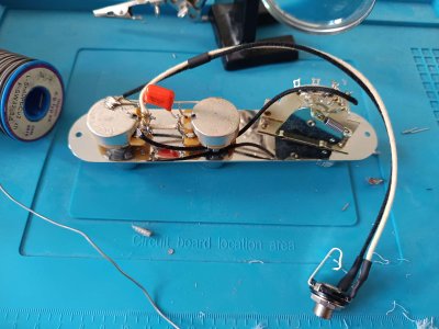

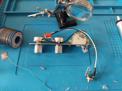

Rockinger also makes pre-wired control plates and wiring kits, I chose the latter because I want a - please don't hit me - reversed control plate and they don't offer that. I know, for some of you this is blasphemy, but so is a contoured telly body, right? I'm a lost cause.
I spend yesterday afternoon soldering that together. It's a classic three way wiring with 250k pots, but with a 22nF tone cap and a treble bleed.

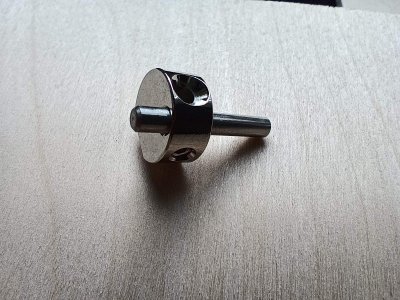

Another non-standard item I bought was that fancy looking "Göldo String Three".

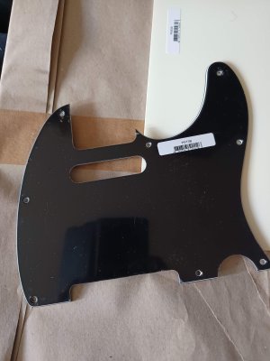

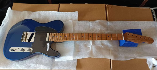

And I bought a black/white/black telly pickguard in case I don't like the blue shell, I hope they line up! And in case I like neither of them: I have a "vintage white" pickguard blank, maybe I try to make on with the cnc.
Now I have to wait for the neck and body. When I ordered them, lead times for "in stock body adding paint/finish" were 12-14 weeks, right now it says 10-12. Ick bin jespannt wie'n Flitzebogen! That is Berlin dialect for "I'm as taut as a bowstring". I'm really excited!

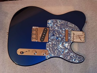

Metallic blue with the Tele chrome hardware will look great! I might have been tempted to do a firebird in that universal route with a white pickguard.
