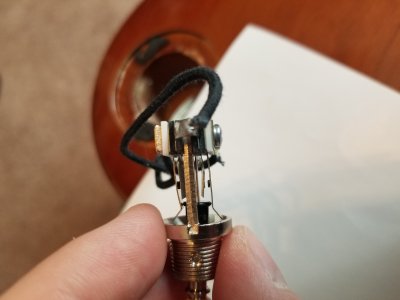

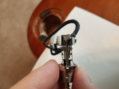

Hey guys, so I'm working on a Les Paul knockoff of mine. Completely gutted the electronics and putting in CTS pots, a Switchcraft jack and toggle switch, etc.
I'm having issues with the toggle switch I bought. When I first got it installed, I noticed that, when attempting to flip from bridge pickup to middle position, there was so little resistance that it would go straight to neck pickup. This is a BRAND NEW switch, by the way.
So I took a small flathead and slightly bent one of the tabs (I guess the one that disconnects the bridge when engaged) to provide more resistance. That worked, but now it seems that the contact points aren't  actually making contact when the switch is in the middle position, meaning dead silence in the middle once this thing is soldered up.
I kind of don't want to screw with it and mess it up more, so I figured I'd come here for advice from those more knowledgeable before I ruin the switch completely. Thanks.

I actually dealt with this a few weeks ago.  Basically you are on the right track.  It is a real balancing act to get all the parts bent correctly.  Once done it'll work fine.
I found it easier to disassemble the switch and then bend the offending sides to match the good ones.  To take it apart, just remove the two screws on one side and then you can gently pry the pieces apart.  You'll see there are two 'tubes' that friction-fit everything together.  Once the pieces are bent to shape, reassemble and test it.  I had to do it a couple times to get the action just right but it is as good as new now.

Those wafers are heat-treated to to be springs as well as conductors, and aren't designed to be bent or otherwise mis-shaped. Your fix is liable to be temporary, which imbues them with some kind of weird sentience that's somehow aware of when the worst time to fail exists.
Fix it, so you know how in a tight spot, but plan on replacing it asap if not sooner.
I'd say that could be the problem, in that the contact tabs were never tempered right to begin with. That or their located incorrectly.
Right. All the more reason to simply replace it. It's just not worth the future hardship. What's $10-$15 against the aggravation of a something as simple as a switch? Same with pots and jacks. Contact cleaner and other temporary stop-gap measures are the opiate of the masses. It's a false hope. Doesn't cure anything as much as it seems to in the moment. Little electrical parts are cheap. No reason to tolerate poor performance. just replace the little rascals and call ti a love story.
