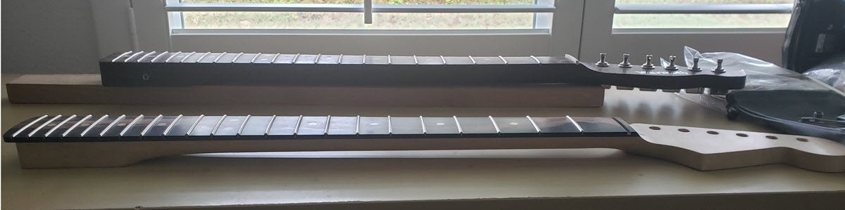

Before buying a boatneck, you would do well to play a vintage style Fender instrument with an old school baseball bat neck.  I happen to love the boatneck profile, but it is VERY far from the standard thin, which has a lot in common with the modern Fender American Standard profile.  Here is a boatneck Tele neck pictured alongside a standard thin Strat neck.  As you can see, almost no light comes through under the Tele neck, but you have nearly a quarter inch of clearance between the Strat neck backside and the table.  So it's considerable.  If you have access to a well-equipped Fender dealer like Guitar Center or Sam Ash, you might find a Richie Kotzen or Brad Paisley signature model in stock. I know for certain the Kotzen has a very fat profile, and I'm pretty sure the Paisley is chunkier than your average bear.
index.php
