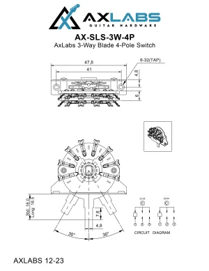

Got a link for the exact switch you are using? I can adjust the diagram
Hey Truper, thanks for getting back!
It's at AxLabs here: axlabshardware.com/products/axlabs-3-way-blade-4-pole-switch
and I attached the only drawing I could find. For some reason I'm unable to post the whole URL. I wonder if it's just moving the 6 string pickups down one lug each as by the drawing it looks like the contacts for that part of the switch are in the middle of the switch rather than on the end of the switch? And then moving the contact for the toggle to the middle...of the switch? If that makes any sense.
You would know far better than I would. Thanks so much for the help!

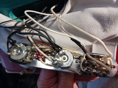

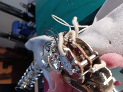

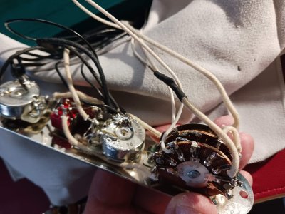

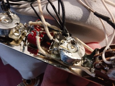

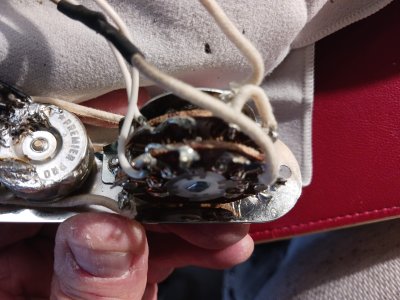

I don't know if these are good enough but here's what I can do so far
seems like you dont have everything in the right order. I cant tell which set is which but the neck pickup on the orange side of the diagram is not correctly wired.
You're right about that. I didn't catch that. I'll try fixing this and see what happens here, thank you.
Everything works except for the middle position (Both necks on) on the toggle. Only the 12 neck is active. Bad toggle? hmmm. Maybe I'll put it together and treat it like a 2 way switch...lol
You're awesome Truper. I really appreciate the help here.
Could be a bad switch. those little switches dont like a lot of heat.
Yep, could be. I have a spare just for this occasion! I think I could also try bridging the middle lugs and switching the 6 neck to the back lug but I'm going to (at some point) rebuild the whole control cavity and discretely widen it out under the control plate (What was Leo thinking?) and clean up all the wiring and soldering. I even have all the "spare parts" for this because I know myself and not always..but usually...it takes me two times to get things right. (nudge)

Sometimes the middle position of these 3-way on-on-on switches works like shown here:
Looks like yours does, too.

LOL...Yeah I'm sure there was a point of "Yep. that should do it." It gets tricky with mini toggles, coil splitting producer switches (snicker), and large Emerson paper and oil capacitors. Yes indeed, I'm going to give that middle diagram a shot and see how that goes. I did a little clip and wire messing around before I put it together and I think that's the ticket.

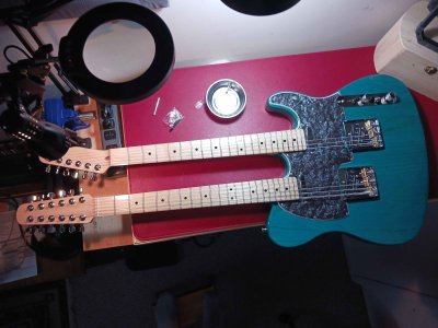

Here's the (mostly) finished product. I really just made this so I could play, A Million Miles Away, by The Plimsouls. Gotta figure out what to do with it besides that, now.

So I don’t know anything about wiring but I am curious.
Why a double neck with the same pickups? Does it sound totally different on one neck ver the other somehow? Strung with different gauge strings?
One neck is 6-string and the other 12-string...? 😉
