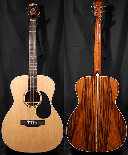

I am thinking strongly about "installing" a soundport in a blueridge BR-63 I just bought today. I was thinking about binding the exposed wood with something like curly koa from StewMac. My question is, do any of you know anything about cutting into a laminate? The back and sides are Brazillian Rosewood Laminate on top of Mahogany.  Also, how difficult is the task of attaching binding? Can you sand down binding to round it?

Cut very carefully.......that's all I can suggest....
But seriously, if you'e just doing a round hole a hole saw would work on a cordless drill. Just drill slowly......
I wouldn't do this, myself.  I can't imagine it will do anything positive for the looks or sound of your guitar, though it will let you hear a bit more of the guitar when you're playing.  This might be a better project for a less-expensive used instrument, or an acoustic guitar kit.  This kind of thing is very hard to execute well as a retrofit - it's much better to build it into the instument the first time.
Having said that, cutting into laminated (aka fancy plywood) sides is actually a better idea than doing it on a solid wood guitar, since the cross-grain lamination will help keep the side from splitting.  Binding on the edge of an acoustic guitar is glued on to a ledge routed into the kerfing strips, so there's a lot more surface area for it to stick to than the thin edge of a hole in the side - getting traditional binding to stick in this application would be a real challenge..  Also, it'd be nearly impossible to bend a piece of flame maple into a radius that small.  You might wind up with a better result by lining the port with a piece of black PVC pipe sized to fit the hole.  You could bandsaw a slice to match the curve of the side, glue it in place, and scrape the front and back level with the sides with a razor blade.

Thanks for the recommendation. I'm with you on it being terrifying, which is why I am going to do it on my cheaper acoustic, but its supposed to have an awesome effect. I found some forums and the guy that builds the ones from the links (Tim McKnight) has instructions on how to do it that involves exactly what youre talking about - a Dremel with a Router Base from StewMac.
I wont be attempting this until Christmas time, but I'll post pictures when I do.
