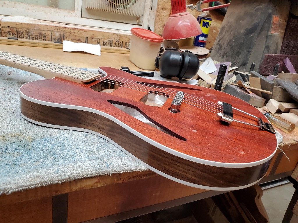

Ok Guys, I hear ya. And I have come to agree. The only thing I've really done so far is add some tint to the binding, no major changes are planned.
The tailpiece in the pictures was made for a guitar with a body at least 2 1/2 in. thick. This body is a shade less than 1 3/4, so I had to trim off the mounting plate for the tailpiece. That meant the chrome was gone at that point. So I made the whole thing look like the chrome was worn and scuffed from years of use. This lead to my considering extending the look to the body. But I've sobered up since then.

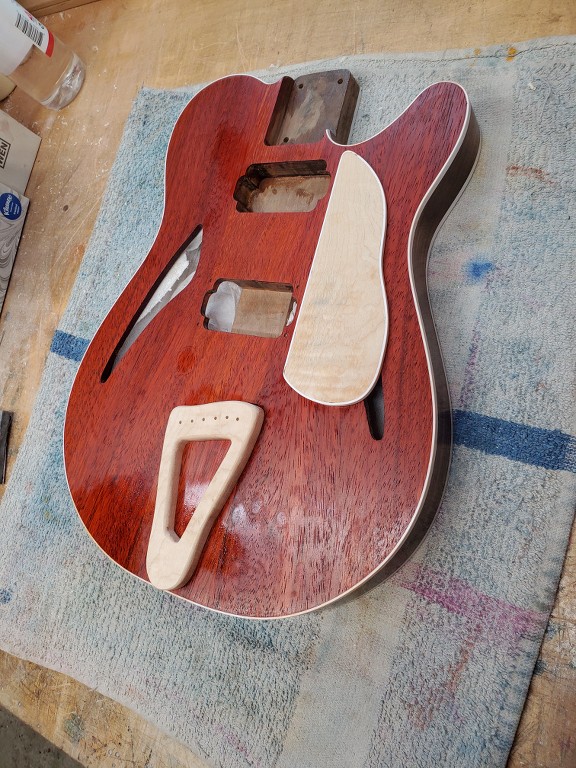

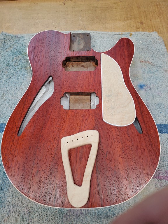

Back where We left off. Ordered a Nickel Tailpiece I found, but a short one for a guitar less than 2 in. thick means that unless your making a Rick, picken's are slim as they say. Decided to try making a wooden one anyway just for fun. Hard maple with some flame in it. A possible pickguard too.....
. Still have work to do on both of them. We'll see what happens.................. :turtle:

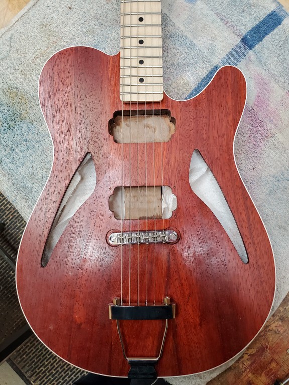

Well, there has been progress. Whether or not it's good progress is a matter that I'll leave for Philosophers and Steve Harvey to debate. Point is, I've gotten some stuff done....

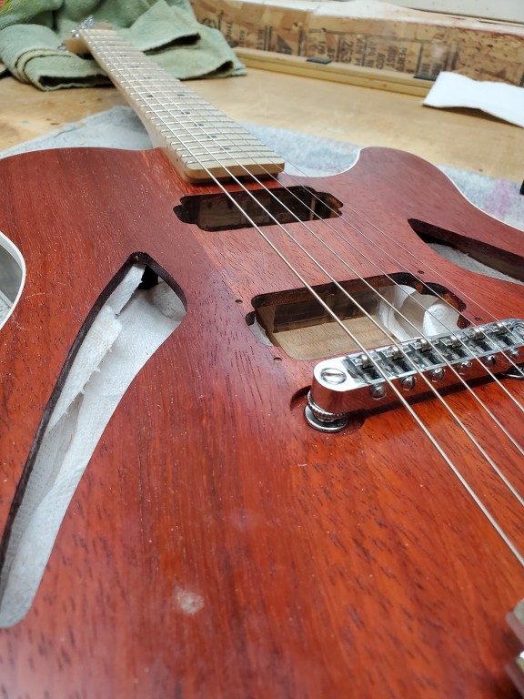

. In order to avoid a neck angle of more than 1degree, I decided to sink the bridge into the top a little. It's all solid under that area, so it won't hurt.

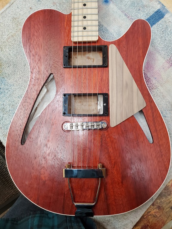

. I'm still on the fence about the new tailpiece, so we'll just keep looking in case there's something better out there.

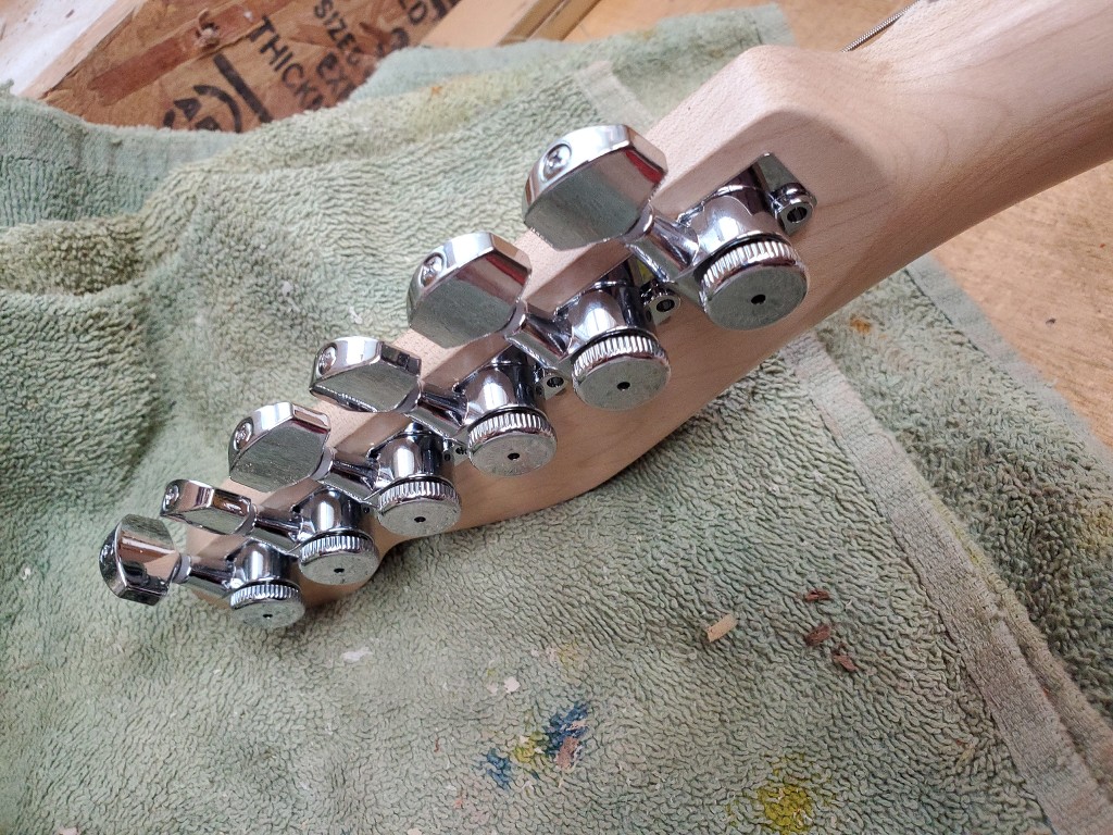

.Going with Hipshot closed back locking tuners, cause, well, their Hipshot.
,Found some LP style pickup rings in a box, and an idea for a pickguard.
. Still have to drill some holes, the output and the controls, but things are slowly getting there. Then it's on to starting the final finish. ................ :headbang:

quote: . In order to avoid a neck angle of more than 1degree, I decided to sink the bridge into the top a little. It's all solid under that area, so it won't hurt.
how did you know how deep to sink the bridge ?
Partly guess work, but mainly by laying a straight edge on top of the frets and seeing where that line hits the bridge. Then measuring from the point of intersect to the top of the bridge. It's not precision, but it get's you in the ballpark........... :icon_thumright:
