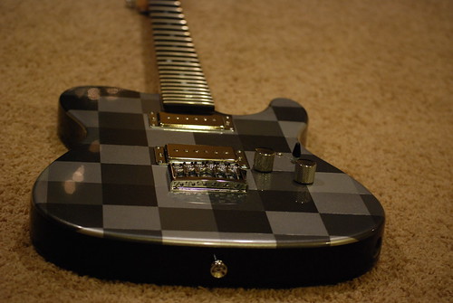

Well I finished the clear coat on the guitar today.  I ended up using two bottles worth of the Deft clear on it.  I let that dry for about 12 hours and then I started the wet sanding.  I went from 600 all the way up to 1500.  The front and backs are easy, but the sides especially around the horn is a pain in the butt.  Luckily no sand through because with metallic paint that would have been a huge pain.  I wasn't completely happy with the polishing on the neck so I bought a little attachment for my drill.  Man that makes it easier.  I used Maguires 2.0 for everything.  I think I have heard of people using two compounds each less biting then the other.  I couldn't find anything like that so I grabbed the scratch and swirls remover.  It seems to work really well.
I decided to install the hardware, at least most of it, and then I can start getting all of the wiring done.  I am going to have a friend of mine help me with all of the soldering.  He builds electronics in his basement as a hobby.  He even bought a tiny CNC machine for making his own circuit boards.  If anyone can get a clean soldering joint I am sure he can.  I want to do as much as possible, but having him there makes me less nervous.  The bridge took three tries to get installed correctly.  The last time I had to take it off because I forgot to put the ground wire to it.  Oops.  Here are a bunch of pictures of my progress so far.  The neck is just sitting there, I don't want to screw it in until I have finished the electronics.
A close up of the bridge.
You can really see the mettalic flake in this picture.  It is also a really good representation of the colors.  At least on my screen.
I like this one because you can see the reflection of the bridge and knobs, plus the flairs from the overhead lights.

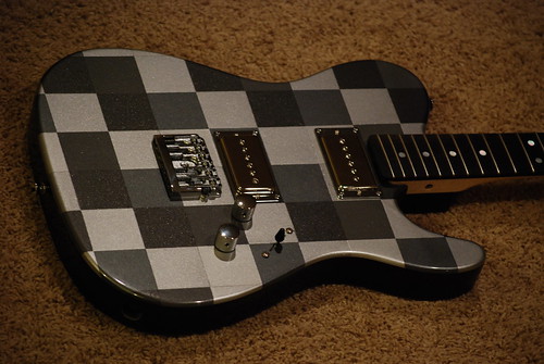

Well here are the pictures first.  I still need to get some in natural light, but these will have to do for now.
I really like the Schaller bridge.  I feels rock solid.  Once you have it set and screw in the set screw it doesn’t budge.  I am really impressed with the bridge.  You can adjust string spacing, individual string heights and intonation very easily.  It was the easiest setup I have ever done.  If I built another guitar I would definitely use it again.
The planet wave locking tuners are another thing I would definitely do again.  They may changing strings really easy since you don’t need to worry about winds or cutting strings.  Plus with the locking tuners I have noticed they stay in tune better and don’t require as much “stretch”.  I am considering another set to put on my PRS.
The Phat Cats sounds very good.  What I read online is a pretty good representation of what they sound like.  They are not as dark as the humbuckers on my PRS.  Sort of like a mix between a strat and the PRS.  They have a nice deep tone to them, but when you role up the volume and get more distortion you don’t lose all the clarity like my PRS.  They, combined with the guitar also sustain better.  I timed both of my guitars and the Tele sustained for about 25% longer.  The volume also fell off in a more linear fashion, where the PRS dropped rather quickly at first.  The pickups also seem to add harmonics that I can’t get as easily with the humbuckers.  They are louder, but not as bad as I thought.  It is pretty quiet, and if you cut the volume before you start playing, no one would hear it anyway.
I really like the neck of the guitar.  I like the feel of the ebony and the think neck is really nice because my hands are not the biggest.  I did a lighter coat of lacquer on the back, and I did not polish it out so it looks more like satin and does not feel as smooth.  This feels much more natural to me.  The PRS has a polished neck with a fairly thick coating on it.  Since it is so smooth and glossy it actually kind of gets “sticky” to my fingers when they get a little sweaty.  The more rough finish on the tele actually makes it faster in my opinion.  I think the only thing I would have done differently on this guitar would be getting the 1 5/8” nut.  I think it would make it even easier to play with my small hands.  I don’t really know if I would like it more since all my guitars have the standard 1 11/16”.  I will probably try when I build another guitar, which I will definitely be doing.
I really like the look of the body and I really like where the volume control and tone control are.  It is similar to my PRS which I really like since I tend to fiddle with the knobs when I play to get different sounds.  The 3-way switch is nice and close as well.  My PRS is tucked further back and almost in line with the bottom of the bridge.  Where it is on the tele I can flick it with my pinky.  The guitar ended up weighing a portly 8.1 lbs.  My PRS weighs 7.2 lbs which make the tele look like it really let itself go.  I don’t really notice it while I am playing and I am used to the PRS so and extra .9 lbs really doesn’t matter to me since the guitar is nicely balanced.
