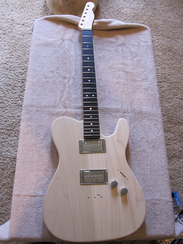

So far this is day one of my silver tele build.
I dry fit the parts just to get an idea of what it would look like all done. Imagine this only with a silver checker pattern.
Here is a close up of the fret board. I have always like ebony fret boards.

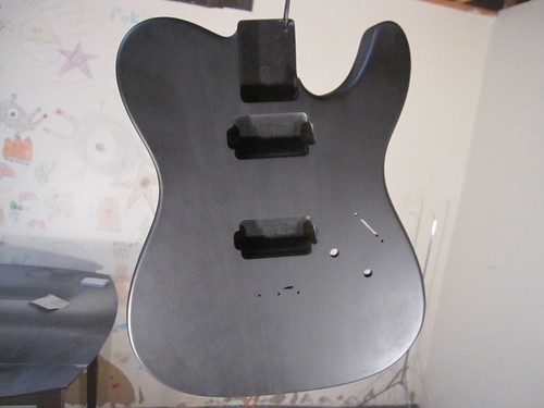

Primer time. I originally was going to do a spray booth in my basement. I gave it a try, but even with venting and fans the fume smell was traveling upstairs. Looks like the garage it is then. Here is the body with 3 coats of primer.

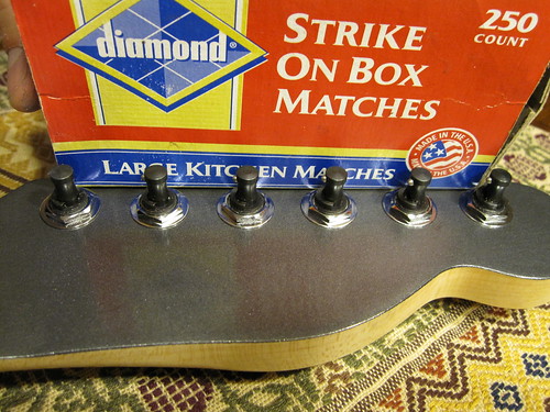

I taped off the neck, primed and painted the headstock. The back of the neck I am just going to seal and cover in lacquer. The color looks darker in the picture, but the reflection from the metal flake is pretty close to what it looks like in person.
The back and sides of the guitar are going to be black and I have started to paint it. I need to let it sit and dry because I was not being careful enough spraying the sides and I splashed the back with a couple of globs of paint. Next time I will be more careful about where I am pointing the spray paint as I press the nozzle down. Despite the couple of spots it seems to be coming along quite well.
