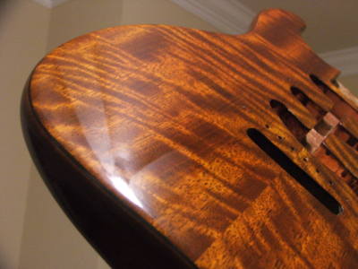

Here's a Jatoba top done with padded shellac.
