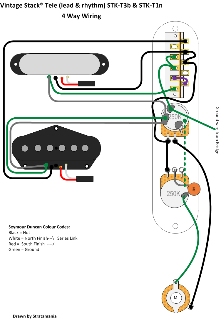

Is it possible to wire 2 humbuckers in series? I'm thinking of using 2 humbuckers and would like to use a 4-way telecaster switch to wire them in series.
I'm also hoping that this would drive the amp (alot) and wondering if this work like an active boost would. I'd like to use a fender TBX Tone control. Can this let me do that without adding any active electronics?
Thanks again!
Heft.
If you are not doing anything in terms of coil splits on the humbuckers via the selector switch just search for a 4 way Telecaster wiring.
If you look in the Tele Build in my signature I used a four way wiring in that which would give you a good idea.
