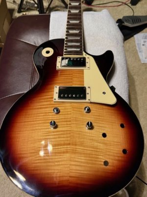

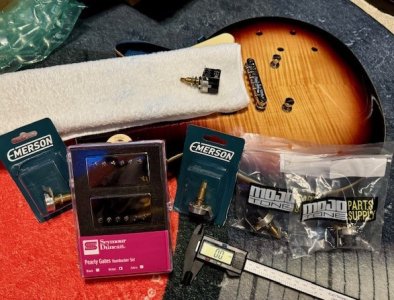

While I'm contemplating my next build I'm going to mod my original first guitar, an Epiphone Bourbon Burst Les Paul Standard, with new Pickups and Electronics.
I would like to be able to control Series/Parallel and Out-of-Phase independently using push/pull pots, but am a little confused on how to achieve this. Either/or is a breeze, but I have not been able to find any diagrams with both options. I already have 500k push/pull pots laying around so I would rather use those if possible rather than say a Freeway toggle. I will be installing Pearly Gates, so they do have 4 conductor wires.
Any ideas would be greatly appreciated.

Ahh, got it, thanks. So would it be possible to have the parallel at the HB level AND out of phase options with push pulls ?
Thanks, any diagrams that you know of ? I cannot seem to find anything in my searching.
Try this, select the number of pickups and volume and tone controls, and then you should have a drop-down list of possible wiring options.
or another approach would be look at using a Freeway switch such as the 3x3-05 model with optional push pulls, the below link is to a pdf with a number of possible ideas.
Thanks ! I see a lot more options now on the SD site than when I was using the refined search. I believe there are several I can make work.
