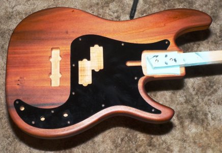

Topalox body with M/R neck about to come to life as a VRB-4.3
thanks :) I think this one is going into the 'price very high so it doesn't sell and I have to keep it' category
R
Worst thing that can happen is you get to keep it, which I'm sure we can all agree would not be a Bad Thing. It's a beautiful piece of work. But, it could sell.
Certainly Fender, Gibson, et al get away with pricing some of their output somewhere up in the stratosphere for no apparent or justifiable reason. Why not give that audacity and hubris a shot? Either everyone will ignore you, or everyone-1, with that one having an irrepressible desire to possess what you've done.
Sometimes you see/hear something and you just gotta have it, price be damned.
Also, you can never raise the price. It only goes down from the start point.
