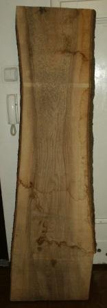

I'm just working on my first DIY project.It is gonna be an ash Tele. Have already ordered at Warmoth neck and hardware but the body will be my own task. I suffer of lack of power tolls and before I buy them need to know whether for cutting out body shape a jig saw is a good idea or should think about a band saw. I bought a nice ash plank which is about 2" thick, 20" wide and very nice although totally raw for the moment.
I've already cut it into 3 pieces which will be planed to right thickness.

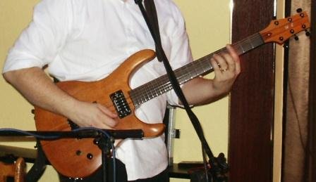

It is actually my first job on a body. I am not a totally newbe in that matter. I have already made a neck through guitar with great help of local luthier ( i'm from Poland). I also tuned couple of axes,changing frets, installing new pickups,shielding etc.I have some power tools and great hope i will manage to do this new body exactly the way i planned.The answer to why i cut the plank into three pieces it was about 80" long - couldn't buy a smaller piece. That way if first job goes wrong i have 2 spare pieces to go on . I tried to attach a picture of that plank but sth failed. Should i have serius problems to cut the body i will turn to my local carpenter . I have a router hope routing neck pocket and pickups will not be a nightmare. Coming back to to my previous neck through please see the pic - if you're interested of details i can write a lot about it.

That plank of wood is so amazingly sexy. Roar.

I don't find that plank so sexy. Actually in Poland we call "a plank" girls with small tits. But it's your preferences i don't mind ;)

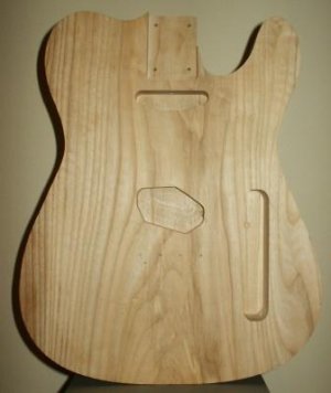

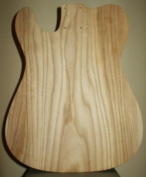

So, my ash plank got it's shape. Still need to sand, stain, varnish etc but looks coll to me. What do you think about the figure? It's in fact hard ash, heavy stuff but hope it will benefit in crystall sound and sustain.
