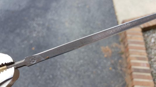

Oh sorry I wasn't clear. I meant for grinding down the sides of a triangular file, sort of like TonyFlyingSquirrel described. I actually bought a set of triangle files from the hardware store a little while back for this exact purpose. When I tried this method a long time ago I removed 1 sharp edge from the file with sandpaper but it wasn't enough and didn't come out looking very good. I'm thinking the belt sander will help me do a much better job...
Yes I could buy the stew-mac version, but, I kind of want to at least try the technique first and I already have these other files on hand.
I don't trust the belt sander not to grab the file & send it through the air as a high speed projectile, so I "crown" the corners like I would a fret, with the flat side of the file laying down on the bench, & the corner topside.
It's a lesson in patience, but I get the precise results that I like because I feel that the Stew Mac ones don't have enough smooth surface to them.  Just my personal preference is all.

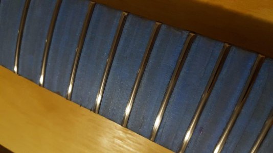

Well I got to work with my belt sander and successfully made a rounded edge triangular file. It worked great on those fret shoulders! It took me a few frets to really figure out the technique, but I can definitely see why some people like them for crowning instead of the concave files.

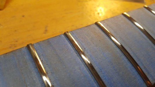

So after giving the frets the correct profile, I sanded and polished them from 220-2000grit and then with my dremel and some simichrome polish. To be honest, I think I did a functionally good but not cosmetically good job... I don't think I spent enough time with the 220grit removing the file marks from the sides of the frets. The tops of the frets where the strings contact are super smooth and polished, but the sides look kind of weird and rough.
Also (related), that part of the fret job sucked! It took forever and wore out my fingers, and I didn't even spend enough time to do it right. I'd love to hear the method you guys use to take the frets from crowned to playable, especially if it avoids tons of sanding with a little piece of sandpaper across the frets.

Once I muster up the patience again I'll re-do the polishing on these frets... For now though I've strung up the guitar and it plays really well. I have some spots on the neck's finish that need to be polished out to a gloss again, and the nut slots are too high still, but things are coming together. there are no buzzing frets so I think everything is level, I'm really happy about that.
Well I tried the crowning file + 3M paper method and WOW! Life changing. (well, almost...) It turned my least favorite part of the process into a quick and enjoyable job. Thank you Cagey for that tip!
Here's how they looked after going through the polishing paper grits, and then hitting them with some Simichrome polish and dremel. Oh and I cleaned up some glue spots and other weirdness on the fretboard with a cabinet scraper.
Like I was asking about earlier, I filed the ends of the frets until the file just started to dig into the finish. So I was left with some non so glossy spots on the sides of the neck. So I used the same 3M polishing papers and then some Novus #2 polish to bring the sides of the neck back to a gloss finish. That wasn't too hard to fix!
So now things are looking really good, I'm calling this refret a success. The guitar plays really, really good with no detectable fret issues with the fret rocker and no buzzing strings. I'm thrilled! It really brought life back into this guitar.
