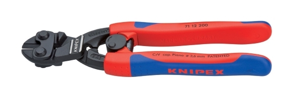

For cutting Stainless Steel look for some tools by Knipex. I mentioned this to Cagey a while back and he is a user now.
Which model by Knipex are you guys using? Something like this?
https://www.knipex.com/index.php?id=1216&L=1&page=art_detail&isMobile=&parentID=1367&groupID=1470&artID=2228
I have a few guitars that ideally I'd like to refret, so I might want to invest in some good cutters.
No, he's talking about the Knipex model 71 12 200...
Wonderful tool. Highly recommended. You can cut stainless all day long even with your wrong hand. I think the biting surfaces must be Cobalt or something, as they don't seem to wear, and the over-leveraged jaws mean it doesn't take much pressure to operate them.

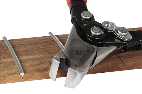

Only problem is they don't cut flush, so you're still left with getting the ends cut once the frets are installed. For that, I've had a love/hate relationship with these. When used carefully, they work like a champ. Problem is, it's very easy to cut slightly off 90° so the top die impacts the fretboard, leaving a slight dent that there's no easy way to get rid of. I've since found that holding them carefully to keep both sides of die equidistant from the 'board, and also having the 'board taped up to act as a cushion will keep that from happening. I'll continue to use them, but the search is still on for something better.
I did find these for flush end cutting...
They're advertised as good for stainless, and have the same sort of design as the Knipex tools, but the sole user comment on Amazon's sale page says he likes 'em better for fret removal pliers than flush cutters, and has some better flush cutters. Don't know what those would be, but I think I'm going to have to one of these.
