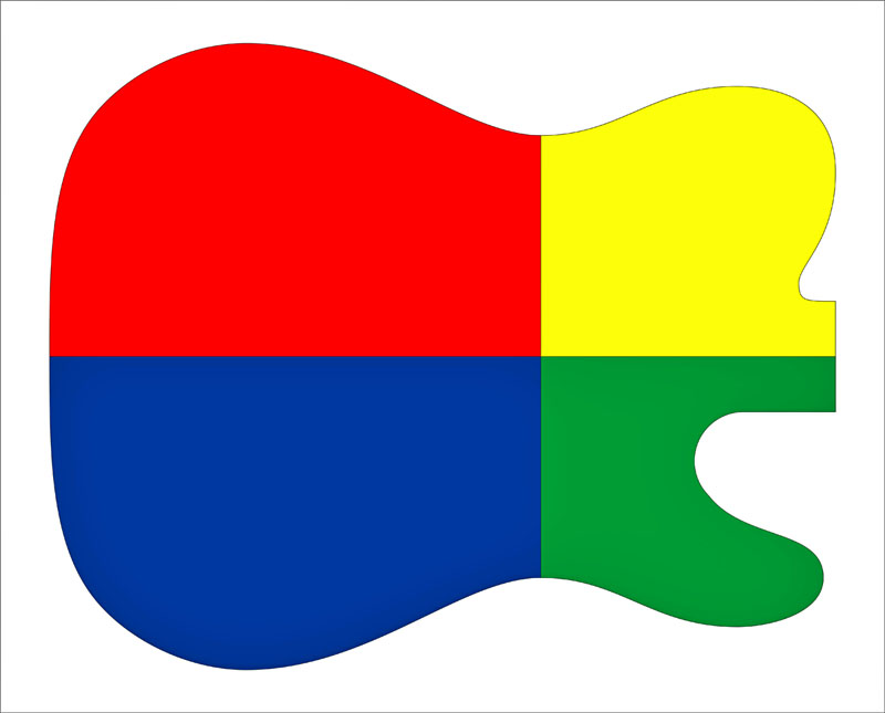

[quote author=stratamania]Thinking out of the box solution for neck dive, put some lead sheet in a body cavity and restore the balance.
[/quote]
Won't work.  Think of a guitar body in quadrants.
In order to affect the balance, you need to add weight in the top-left Red quadrant, and as far to the upper left of that quadrant as possible.  Adding weight in any other quadrant will either not affect the balance at all, or make it worse.

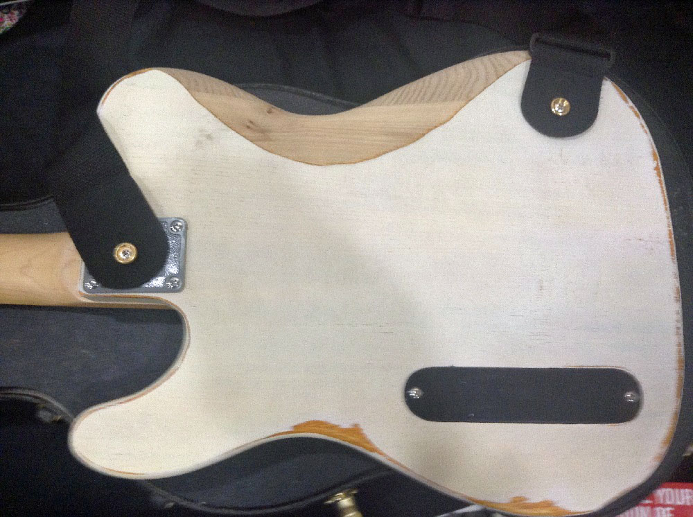

Alternatively, you could adjust the placement of your rear strap button within the range of that same quadrant.  You'd essentially be redistributing the weight that is already there to fix the problem.  This is how I have the strap buttons located on all my Tele-style guitars...
... which also eliminates any twisting in the strap, by forcing it to lie flat against my body.
I like that.
That is actually a solution I've been contemplating - moving the back strap button. Perhaps not so much as you've done, but further up the "red quadrant".
[/quote]
It was a tongue in cheek comment.
But if we want to discuss it. It could work as I never said which body cavity or where it is located. Also, where is the point of balance that is trying to be achieved and for whom?
Sorry but the quadrant thing I am not buying. If the body is of sufficient weight the neck will not dive. Sure if it has already dived you may have to push down on the upper quadrant to reposition it, but if you wanted to stop it diving in the first place weight in the red or blue quadrant or distributed across both is likely to work just as well.
Or horror of horrors get a heavy enough body in the first place.
I'm totally with you on just getting a sufficiently heavy guitar.  I never liked a Parker Fly because it felt like nothing.  Most hollow bodies and semi-hollows don't work for me.  I've currently got a Chapman ML-1 Hotrod (Floyded Super Strat) that I feel like is too light — I want some "opposition" (for lack of a better description) when I hit a guitar, and it doesn't give very much of that.  But I cut up a few guitars figuring out the quadrant idea.  Adding weight in the Yellow or Blue will have almost no effect on fixing neck dive.  Adding weight in the Green will make it worse (or conversely, hollowing out the Green area will help, but since that bout is typically so small, removing a couple of ounces there won't make a huge difference).
