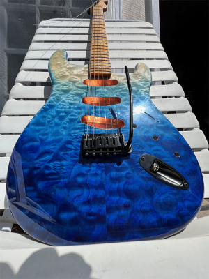

Quilted maple cap over chambered ash body.
ieruiz
New member
8
I did the finish.  I used Feibling's leather dyes.  Alcohol based.    Then about 8 cans of spray on lacquer, followed by wet sanding, then final buffing.
Respect. Outstanding work!
