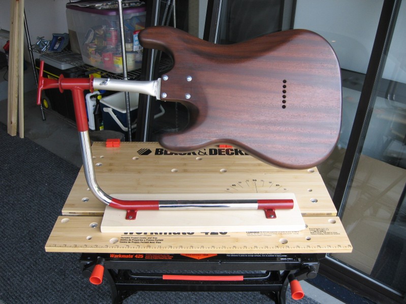

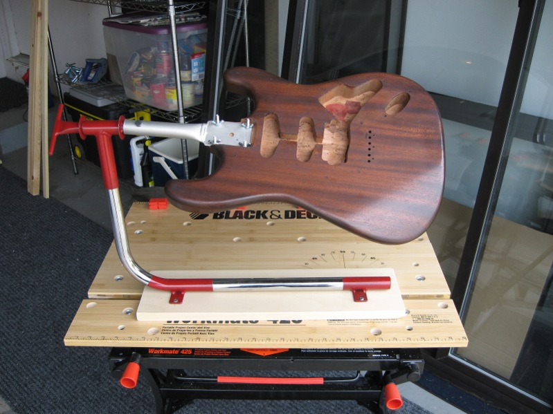

I was doing that when I started my mahogany Strat body...
You can't see the vise in that picture, but it's just below the stick the body is mounted to. Works like a charm. Haven't worked on it since then, waiting on weather and tools, but I just got it set up to get back to this week. Got a different jig to work on it with now...
It's just for finish work, but it'll be good for that. The stand I got from another member here who's fabbing them up in his garage. He has a thread describing them here if you're interested.

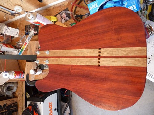

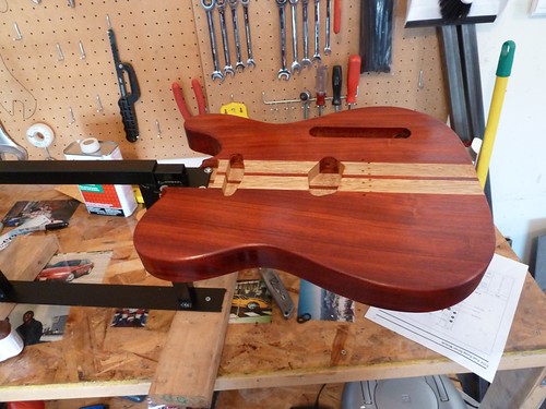

Took about a half hour to make this, then a couple hours for the paint to dry.  Not nearly as fancy as the ones Pirana makes, but it gets the job done.  Didn't have any round tubing, so I used square tubing.  I can still slide out the inner shaft and set it at 90 degree angles.
1st coat of Tru oil
