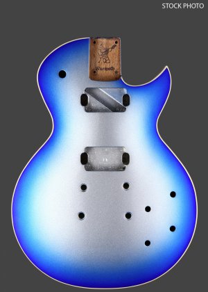

And how about Metallic Caribbean burst, is that white pearl in the middle, and purple on the outside?  It's solid right?  Is it candy blue metallic?  Or just plain metallic blue on the outside burst.

I'm really intrigued by Metallic Caribbean Burst, but I've never seen one in person.
Do you know what the color is in the center?  I'm assuming it's white pearl, while the outside is a blue or purple pearl.
Thanks
Not, sure, but comparing it to the similar Metallic Candy Purple Silver Burst, my guess is that Metallic Caribbean Burst is the silver base coat (for the candy colors) with blue candy shot only as a burst.
Well that makes sense, the paint is called metallic, so I guess the inner part is probably silver with aluminium dust mixed in, and the outer is a candy blue.  I guess the only way I'll find out for sure is when I'm ready, give Warmoth a call and ask.
Metallic Caribbean Burst. Silver to Blue.

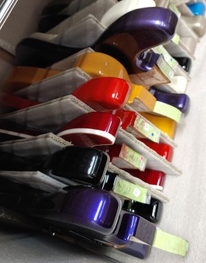

Here's a photo of Candy Purple and Purple Frost in the Wild.
Purple Frost is the top, Candy Purple is the Bottom.

ive always been more of a celtic frost kinda guy, but that purple frost is making feel things. amorous things
This is the clearest comparison of Purple Frost and Candy Purple I've seen! Many thanks!
So, Purple Frost is more purple-y, and Candy Purple is a little more bluey-purple.
I've been considering the purples among a few other options, and this tells me pretty well that Purple Frost is more my kind of purple than Candy Purple.
