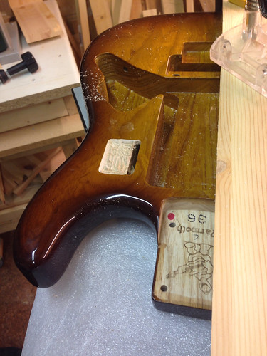

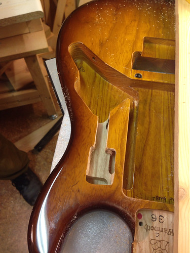

I want a 3 way (Gibson type) pickup switch placed where the strat is not routed - so some DIY routing was necessary:
Had good help from my uncles neighbor:
Here it is started:
Almost finished (forgot taking a pic when it was sanded and smooth). You easily see that this is a chambered body:
And it's getting more chambered all the time! <grin>
