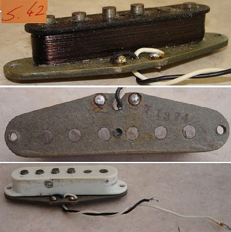

Those pickup routes do not look like you could fit a standard Stratocaster single coil pickup in them without modding the existing routes, see the pic below and notice that the bottom of the pickup is NOT straight across like the routes in your body:
this is when it was original
