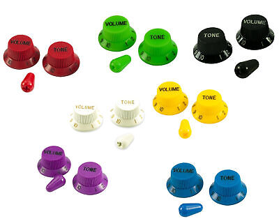

Let me see if I can find a link for the pink knobs I found that match the dimarzio pink. If not I think I have a couple left that I would be willing to part with.
Seems the store I bought them from has deleted their ebay account but this looks to be the exact same thing. If you are interested in the ones I have that I know match better than the ones in your pic, shoot me a dm.
I ordered these, thanks!
