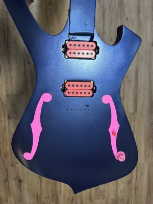

I got one can of color left so I’m going to try knocking down this with some 600grit and then I’m going to pray
Ugh as I look again I spaced the left f hole on edge to vinyl not vinyl to pickups. Terrified to see what happens if I try to lift this vinyl and move it :(
I would pull it up from the arm cut. The adhesive is probably water based and MAY come off without damaging the blue. Dunno
Will give it a go. At this point if I end up pulling up finish I’m taking a winter hiatus on this project 😭😅

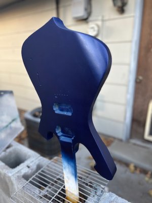

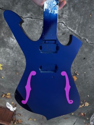

@Hagwood @Spud you fellas online? What do you think my chances of getting a decent spray of this 2K Spraymax is in ambient temps of 60 degrees… no wind and no humidity concerns.
I haven't used that specific product, but 60 should be perfect for spraying.
I think that's pretty good conditions, and the aerosol Spraymax does go down nicely. Just pay close attention to the flash times between coats. I don't remember them off hand but I think they have the directions on their site. It's not very long, 5-10 mins IIRC. I used it before going to the gun and used one complete can during one application, then waited a few days lightly sanded and used another can. Probably not entirely necessary as one can may be enough. MAKE SURE TO WEAR A REAL RESPIRATOR AND GOGGLES, AND COVER YOURSELF UP ! That stuff is deadly in your lungs.....
Aye aye sir I am using all of my PPE. First can is on. Wow does it make the metallic pop!
