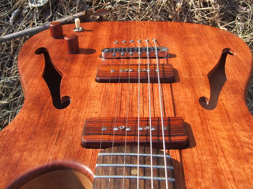

I have a set of P-90 in Cocobolo.  Wound to vintage specs, Alnico II and V magnets.
A set of Woodbuckers, also in Cocobolo.  Wound to vintage specs.
And a set of Telewoodies in Pistacio.  Wound to vintage specs, the bridge has a zinc plated baseplate.
As I go back and read more...  I too would like to chime in on going with better parts.  GFS does make some good pickups.  I've read well written reviews that rave about them, I've read well written reviews that expressed disappointment.  I had strat with a set for a while, and I was quite happy.  I actually wish I hadn't sold the ax.
That said, Don't skimp on your bridge.  Its what attatches the strings to the body, I don't have any scientific reasons, but IMHO its worth an extra $20 for peace of mind.  And tuners as well, you don't need to buy anything high end, but again, $20 extra for peace of mind.  Research your decisions based  upon materials and specs, not price.
I say this because, while my two thinlines look amazing, they've been a real fight to get setup.  I went cheap with the necks.  I bought them on ebay from Karosa.  He makes amazing looking necks.  You can get them CHEAP.  He sets his auctions for 24 hours, so if nobody's bidding, you can get lucky.  Neither neck cost me more than $80 after shipping.  Both are Goncalo Alves, one has an Indian Rosewood fingerboard, the other has a Marblewood fingerboard.  They look amazing.  However, there were some inexcuseable mistakes.  On one, the tuner holes are not a consistent distance apart, two tuners holes were so close together that the tuners bumped into each other.  On the other, two of the string paths cut into the nut were too close to each other.  And on all his necks, the Truss Rod adjustment is hard to work with.  My Epiphone LP Custom plays like butter in comparison.  THAT SAID...  with a great deal of work, I've finally managed to make them almost as playable as I'd like.  I'll be keeping them, I've become a huge fan of Goncalo Alves for neckwood, especially raw.  One has a back contour to die for.  And they both sound good.  But if I knew then what I know now.....  I'd have saved my money for another month and gone with Warmoth necks, not exotic if I had to.  I've put too many hours and had too much frustration working with the inexpensive Karosa necks.  But who knows, he builds them one at a time, and I imagine his work improves over time.
To sum up...  Wait a little while and save up another $100, at least, for quality parts.
I'm impressed that you're coming in around $400 for your guitar.  Thats cool.  It makes me want to sell something and go buy parts.  I actually have two more Karosa necks I need to do something with (one is Sapele with a Zebrawood board, the other is Jatoba/Jatoba), I got them both insanely cheap, and both appear to be as good, if not slightly better than the ones on my Thinlines.
