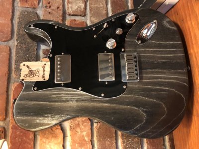

Why not put in a dedicated kill switch? Easy peasy and easily swapped and will outlast pp pots.
That's a much better solution than a PP Pot.  Plus you could put in a 5 way switch and get some funky combos.  Do people use funky anymore?  I heard a kid say, "that's cray cray!"  So  ... some cray cray combos, but I think that might be a little strong.
