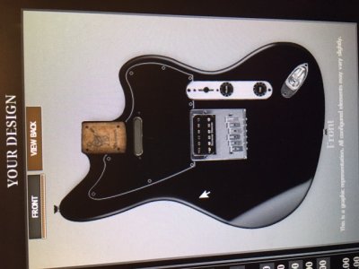

Hey everyone. I'm soon-to-be a first time Warmoth buyer, and this is also my first custom guitar. I'm not going to put it together myself (I don't want to mess it up), but I have a guy locally that I go to for all that sort of stuff. But, before I take my parts to him, I want to know for sure that I have everything I'm gonna need for him.
This is what I'm going to order (if it's not loading, it's attached to the bottom of this post):
IMG_0118.jpg.html
Everything in the pic will be with my order. My question is: what else do I need? I saw the portions of the site for wiring, switches, pots, etc. Do I need to order all of those parts as well, or will they come with my order? I know that's a really newbie question, and probably has an obvious answer, but I'd appreciate any answers/advice! Thanks!

Warmoth does not include freebies with orders. If you want pots and wires and such, you have to order them.
Here's a basic checklist that looks like it should cover everything on your guitar.  It goes from heel to the tip of the headstock
1 - strap buttons
2 - output jack plate
3 - output jack (please use a nice switchcraft part)
4 - control plate
5 - two 250K linear <ahem> log pots with shafts that match your knobs
6 - one 0.047uf cap
7 - one three way tele switch
8 - two knobs
9 - one switch tip
10 - bridge
11 - bridge pickup
12 - pickguard
13 - pickguard screws
14 - neck pickup
15 - neck plate
16 - neck plate screws
17 - neck (well, you never know)
18 - nut (just order it with the neck)
19 - tuners.
20 - string tree(s).  Not required if you use staggered shaft tuners.  Get locking ones as well while you're at it.
with all of the above there is an endless number of options as well.  When you get into it myself and the rest of the folks here will offer endless suggestions and opinions on all of it.
Have fun and good luck.

Two linear taper pots?
I love linear taper pots (for volume only) on basses, but for a guitar, the audio taper tends to work better.
I'm a big fan of linear volume pots for guitar. I agree with you on "volume only" though, linear taper tone pots aren't very useable in my experience.

Linear and log are a completely subjective matter. You should order whichever taper you prefer.
Same goes for the pot and capacitor values. There's no right or wrong values to use.
Personally, when mixing humbuckers and single coils, I like to use 300k pots. But then, I also don't have tone controls on any of my guitars.
As far as every other part goes: if you don't order it, Warmoth won't supply it. Warmoth send you what you order and nothing more. Nothing is thrown in for free, nothing is assumed. If you don't specify something, they don't do it.
If you have any doubts, ask the person who will be putting the guitar together for you; they probably have a better idea of what is needed.
