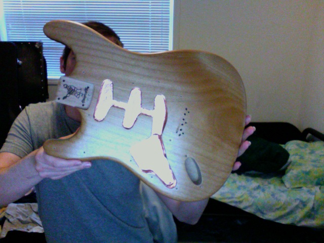

So after spending several hours a day for months pouring over the warmoth site, I finally took the plunge and snagged a warmoth 1pc alder strat hardtail body on ebay.  Now, I need to decide on a neck.  I have this irrational fear that choosing the "wrong" wood will make my guitar sound like crap.  After lurking in the forum for a long time, I get the impression that I could basically close my eyes, throw a dart at a list of W options and anything I hit would sound great, but I still want to make sure I match my choice to the tone I'm after as best I can.
I've bought into the raw hype and am a sucker for ebony fretboards anyway, so I think my options for a back wood at the moment are Wenge, Goncalo, Padouk and Canary.  I'm guessing canary and padouk are going to give me the most maple-like tones, but how different will something like wenge or goncalo be from the traditional strat sound?
Not that I’m too concerned about sticking to the traditional tone, but I would like to keep the snap and clarity of the strat sound as well as a tight, thumpy low end.  I'm in a cover band that plays a lot of classic rock stuff, but my personal taste is a super-clean, neck pickup, fingerstyle sound that leans more toward jazz.  I find myself going for scooped tones fairly often, so is wenge (with its pronounced mids) even worth considering?

The body is routed SSS and that's what I'll go with initially (may rout the bridge for a HB at some point).  I like what I've heard about Pete Biltoft's pickups at VintageVibeGuitar.com and am interested in trying a set of either his strat-sized P90s or strat blades.

Backhair, did you get that from ebay a few weeks back? I was the next bidder under you, even though I have no need whatsoever for another guitar. Wax finish, right?

tfarny: yep that’s the one - didn’t mean to snipe you!
