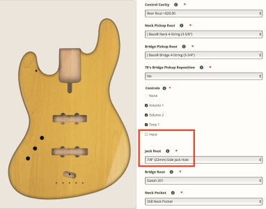

Thanks for your replies thus far. Some initial questions:
1. Per the attached image, what's the input control, is that for an active bass? I'm planning on passive.
2. Is that a good jack route choice?
3. Warmoth's site says that double-expanding truss rods are standard on SSB's.
- what are the rods made of? I remember reading that graphite is lighter, which helps alleviate neck heaviness and helps with the balance of the instrument.
