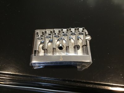

Well this beauty showed up today.  The most I ever paid for a hardtail bridge.  This has serious adjustment capabilities.  I hope it sounds as good as it looks.

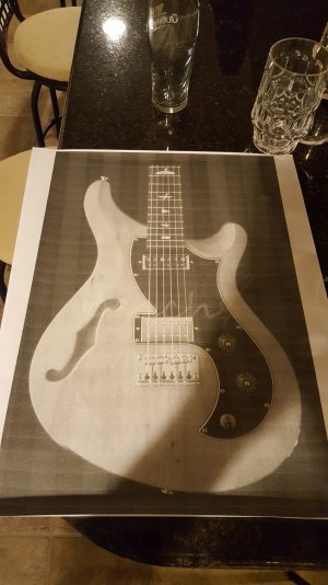

I also made a template to work with.  Along with my actual S2 Vela, I should be able to make a nice copy.  The thing that scares me the most is the body contours.
I have a box of wood planks ready to glue and shape for Monday
That Schaller 475 looks awesome! I fully intend to use one on some future build.  :icon_thumright:
It's one of the most adjustable hardtails you can get, plus it has a lotta mass. The only caveat would be that you have to watch it when changing strings - without tension on them, the saddles will rotate out of place fairly easily. Fortunately, they're easy enough to rotate back into place - you just have to get the string tension off them so they'll move.
